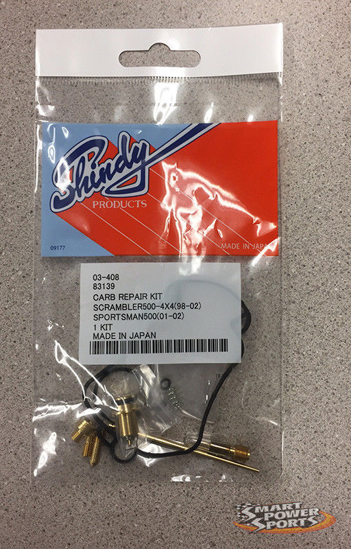

Welcome to the forums. Shindy makes the best carb kit but think you have other problems. Always turn the fuel valve off on older models whether 2 or 4 stroke after use as gas can flow straight into the engine whether fuel to the carb is by gravity or even if it has a fuel pump like the 500 has. The BST40 is a hard carb to set the float level on and must be set right or it will overflow or dump fuel into the engine.Carb must be turned side ways until the float tab barely touches the float needle plunging pin. The float should be parallel with the carb bowl at this point.You can adjust the float tab by bending it up or down.Hopefully that will solve the problem.
Attached Thumbnails polaris scrambler gas in motor issue?!-s-l1600.jpg   polaris scrambler gas in motor issue?!-2471649347_b2a1a773d6.jpg
