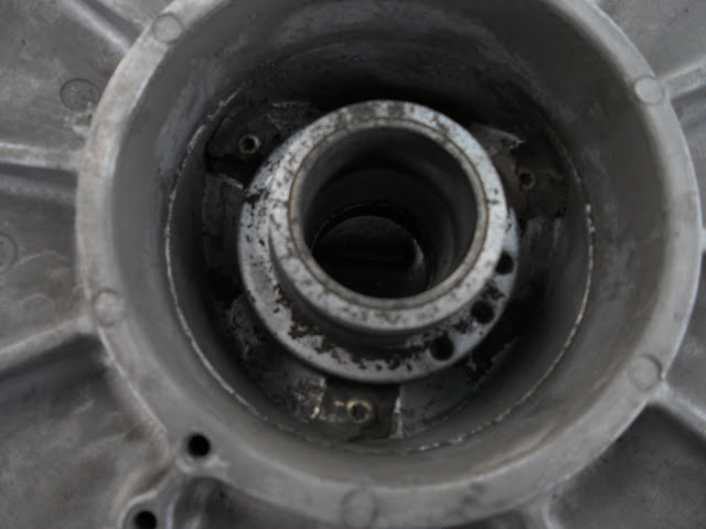

If the thumb lever has too much slack the etc contacts would touch and the machine wouldn't idle. Needs to have 1/8" max play at the lever.I'd still pull the black wire from the limiter just as a process of elimination to see if it's causing loss of power. If it still does the same thing,head for the clutches. Check the belt for excessive stretch or glazing.Just place a straight edge over the top of the clutches and pull down on the center of the belt.If you have more than an inch and a half play from the top of the belt to the straight edge,time for a new belt. Most common cause on clutch problems was the belt and the 3 ramp buttons in the driven clutch ground down over time.The manual goes into detail on the clutches and repair if needed.I've found a lot of ramp buttons like this or worse.If worn down the helix can slip and you loose power.

She seems to be missing and back firing not slipping on the belt.
