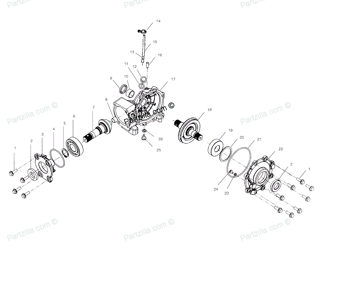

Welcome to the forums.This model has the ring and pinion gear,bearings and seals,doesn't have the awd system like the later models. It may not be as damaged as you think but you need to tear it down to find out.If the ring and pinion are still in good shape,cheaper to repair it then to pay almost $900 for a new one.
Attached Thumbnails 2000 sportsman 500 help-e6df7ea68adbf737be78265672b3b1234bbca797.png
