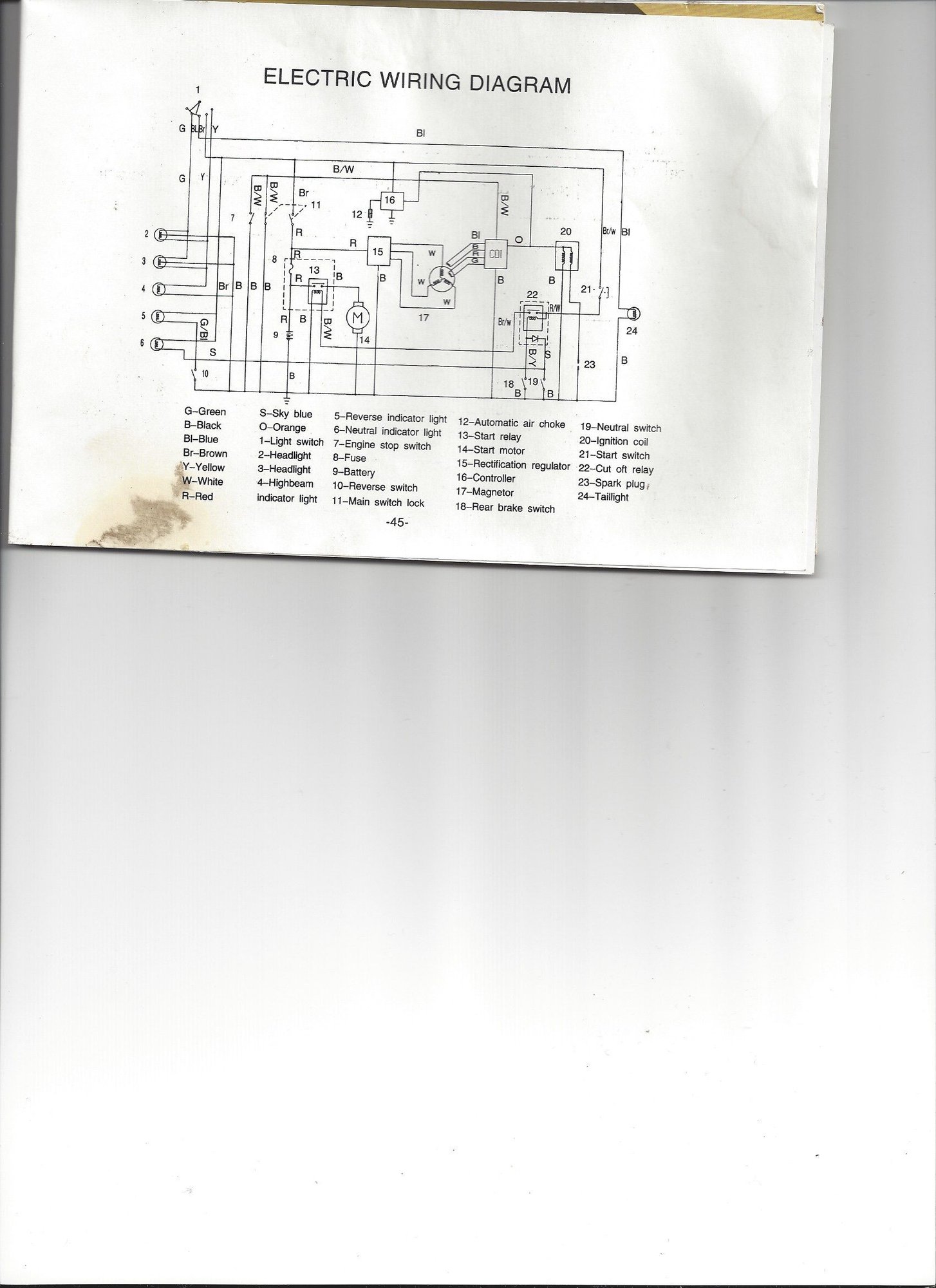

hi im new here, not real well versed with forums. I need help rewiring my Yamato 250cc ATV.

all the wires on the handle bar. and the colours on the harness don't all match. how am I supposed to figure this out?
