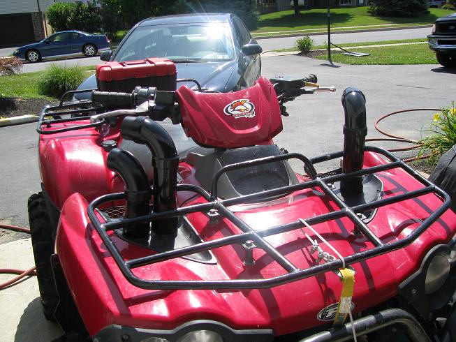

I've been looking for pics of the CVT snorkel??????????????
KAWASAKI BRUTE FORCE 650-750 SNORKEL KIT $169

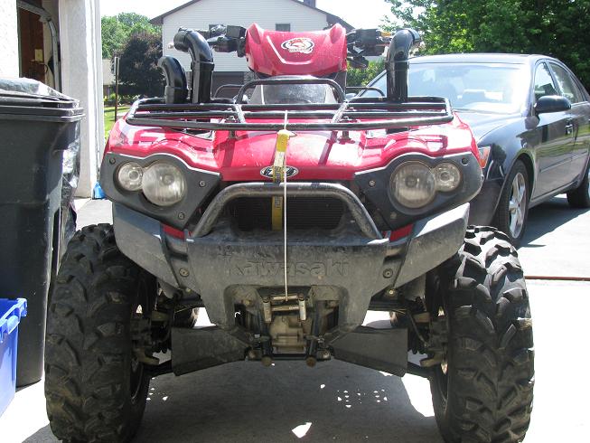

Default 650750 brute snorkles
Check out MIMB web site for snorkle instructions. Or I could take some pics next time plastics are off.I would do snorkles yourself with ABS black plastic tube sold at Lowes or your local plumbing outfit - 2" on CVT intake and exhaust and the recomended 3" for carb intake at air box. It"s easy to side snorkle,not sure on the center snorkles though - I prefer snorkles on each side.
Attached Thumbnails 06 brute 750 various questions-img_3712.jpg   06 brute 750 various questions-img_3719.jpg
