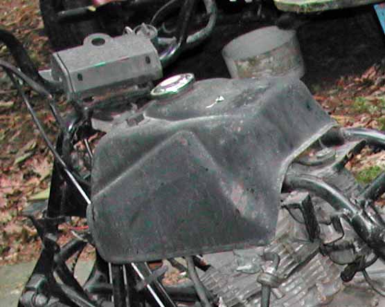

Hugh, you can help me out.
My KLF300A2 has a steel fuel tank. KLF300Bs all seem to have plastic tanks.
I am going to replace my steel tank with a custom-made stainless steel tank,
or substitute the newer plastic one.
Since you have both an A and a B, can you tell if the newer tank will fit the
older KLF300A?
older KLF300A?
Well, never mind. I just bought a plastic tank from a 91 KLF300B for
$35, and I will see if I can make it work. Different mounts, but those are
easy enough to weld onto the frame.
