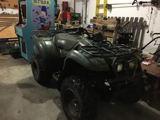

Hello everyone! I'm back to a Kawasaki!!!! I just picked up a new to me 2002 Prairie 300 2wd. The quad drives in reverse, but won't drive in forward. When you try the forward gears, it'll make almost a grinding sound....sometimes, if you get lucky, you can put in in H/L and you'll get no grinding.....you can drive forward about 4' or so, and then you'll get the grinding again. At first I thought maybe it was a rear differential, but because its a 2wd model, and reverse works fine - I no longer think thats the issue. I am REALLY green with all of this, so I don't even know where to look.....hell it may be the rear differential. There is a lot of documents/tutorials on how to swap the rear end, but nobody seems to tell you how you know if you have a bad rear.....
Today, I put the quad in reverse like normal.....but as soon as gas was applied it wanted to die.....after running for a few minutes, it seemed to alleviate that problem as well, but I noted it. I don't know where to start with this ATV, but I'd love to learn. Anyone have any ideas as to what this could be?
