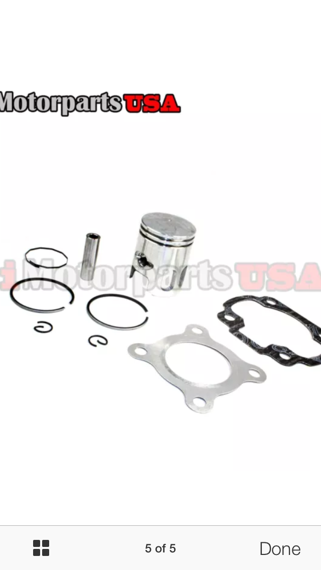

Posts: 35
Ok last one. I promise lol. What is the small hexigonal ring in the upper left? When i took the top end apart i didnt see one of those. Exhaust gasket?
