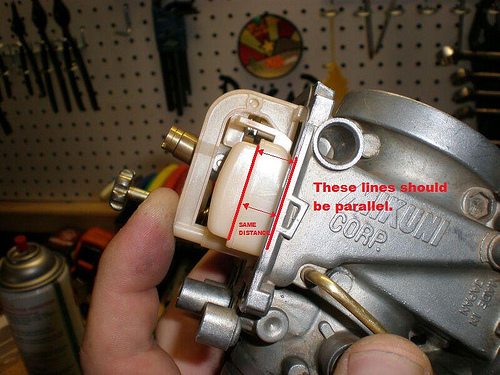

Got the carb rebuilt. It started up and ran fine--maybe a bit rich--for about 10 minutes and then died. Looked in the air filter box and it was half full with oil and gas. Now I guess I take the whole thing apart and look at the valves?
Old Mar 4, 2017 | 06:32 AM
  #29
Hopefully you did replace the air filter. Still sounds like carb related especially if you don't have the float adjusted properly.Hard carb to get right.Here's how to adjuts one,plus you can use a clear tube on the carb drain bow nipple to see if fuel rises above the bowl.Also check the oil tank ad see if it's overfull or smells like gas. Change the oil and filter if needed.
