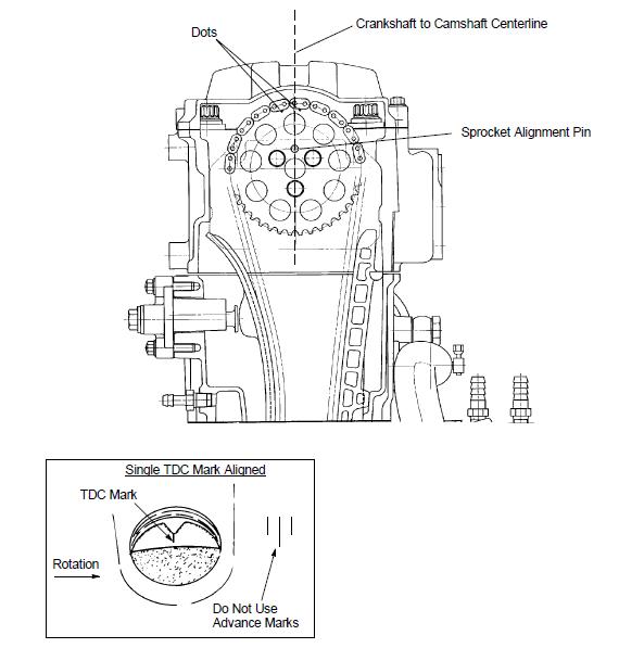

I noticed something interesting while messing with it, that I should have noticed earlier. It appears that the flywheel timing mark doesn't line up with the inspection hole when the camgear dots are in the proper position in relation to the head, i.e. parallel. It seems the timing mark is about 3 teeth too far advanced on the flywheel, past the mark in the inspection hole.
It also looks like someone had the head off somewhat recently becuase it's spotless under the valve cover and the bolts have the usual marks on them that comes from having tools on them.
I was going to pull the flywheel and stator and verify the timing chain settings but cant' get the damn flywheel off!
The question is, that timing mark is supposed to line up with the mark in the hole in the cover right?
Bad cam timing will certainly cause issues like I"m having!
Old Sep 28, 2016 | 01:10 PM
  #17
Yes it would.. You need a good harmonic balancer puller to pull the flywheel. Sometimes they may be a little tough. Heat helps on the crank shaft. 1/2" impact gun is a must! Here's what timing looks like using the plated links for a guide courtesy of another member.https://atvconnection.com/forums/pol...ml#post3305250 Plus a pic from the manual.
I"ll go "rent" a puller from the parts store. I tried heat with a little 2 jaw puller but it wasn't budging. I didn't want to put too much on it though for fear of messing up the stator.
