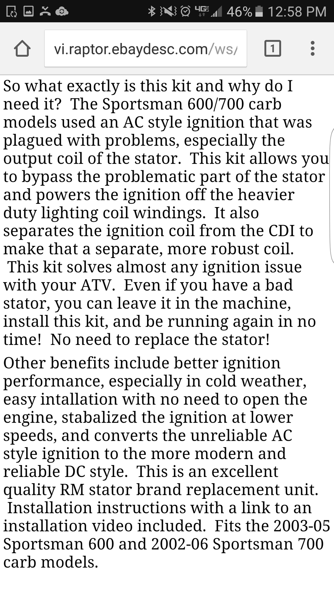

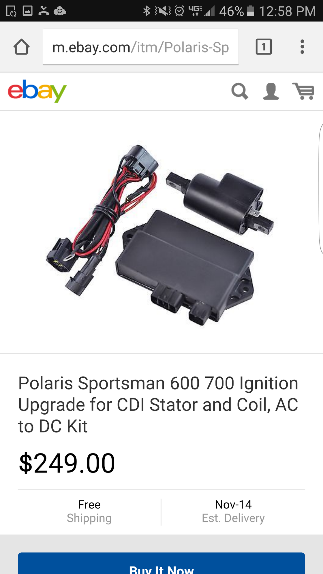

Is this the same thing?
Old Nov 4, 2016 | 02:26 PM
  #19

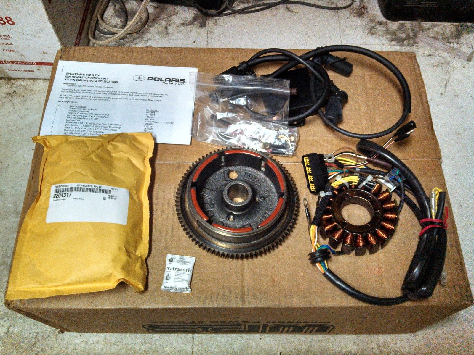

No,NO,NO That's the one I said that was cheaper but used the Ducati lighting coil as the ignition source. I've had lighting coils go out also,then you'd be stuck! Get the Kokusan kit designed for it. #2202603
