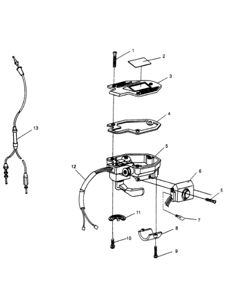

I have a 2000 sportsman 500 and the indicator light on the handle bars for the AWD is not lighting up. I have snipped and grounded the two brown wires that go to each wheel due to my speedometer crapping out and my AWD works but the light does not. I'm just being **** but I would like it to work. Does anyone know if that bulb can be replaced and if so where I could get one
Thank you in advance
Old Feb 3, 2017 | 05:51 PM
Technically no unless you like cracking things open and trying to find parts for one.You can only buy the lower assy if you're traced it down to the switch light itself.

After grounding the two brown wires it will go in and out of AWD I quickly pulled the switch apart last night and it appears to me if that switch works to engage and disengage the hillyard clutches the light should work. but I'm no expert is the light supposed to be a part of the circuit or should it still work with the bulb blown?
Old Feb 3, 2017 | 06:10 PM
Early models (94 and before) with the separate awd switch had a bulb that could be replaced and did have to be good to complete the circuit. After 94 the bulb could be replaced but didn't complete the circuit,just a indicator only,the same as yours.
