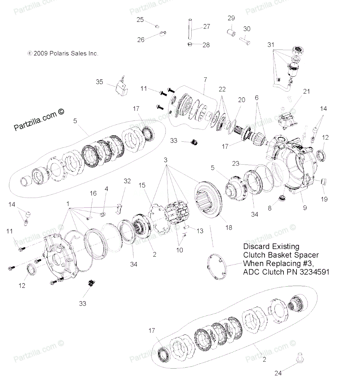

Ok just checking it has play were it goes in the diff is that normal too
Old Mar 1, 2017 | 03:41 PM
  #15
There will be some play from the output hubs in the front diff. If really excessive,then the output hubs may need to be replaced.Items#2 and 5.
