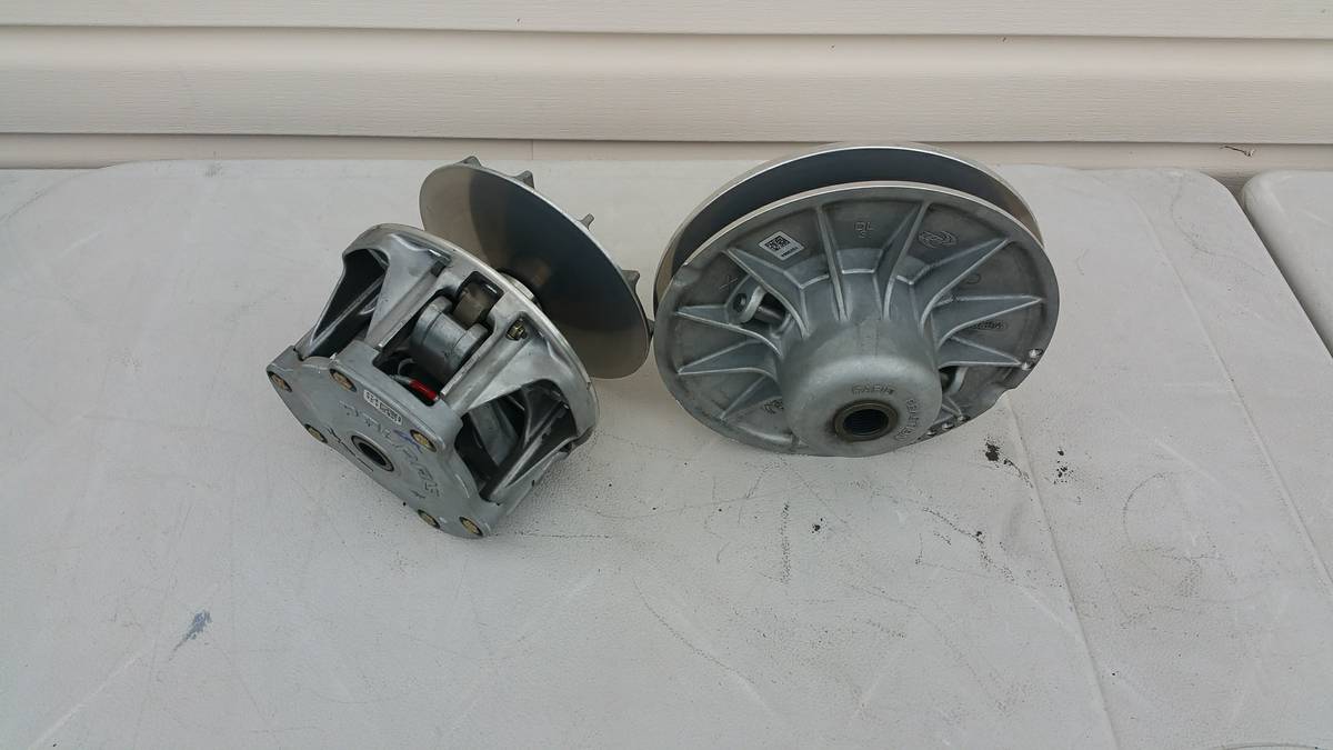

Default Can you tell if ebs by looking at pics?
The owner stated that the clutch set came off a 2013 razor 900 but didnt say if it had ebs or not. These are the actual photos of the clutch set. Can you tell if these will work on my 95 400 sportsman?
thanks again OPT.

Ebs clutch system.You want the non ebs. Along with your model clutch and older models, these drive clutches share the same part number with yours.
Usage : 1321632

Same for the driven clutches.

Ebay has used ones along with aftermarket clutches that would work.POLARIS SPORTSMAN 400 PRIMARY DRIVE CLUTCH 1994-2011 BRAND NEW | eBay
