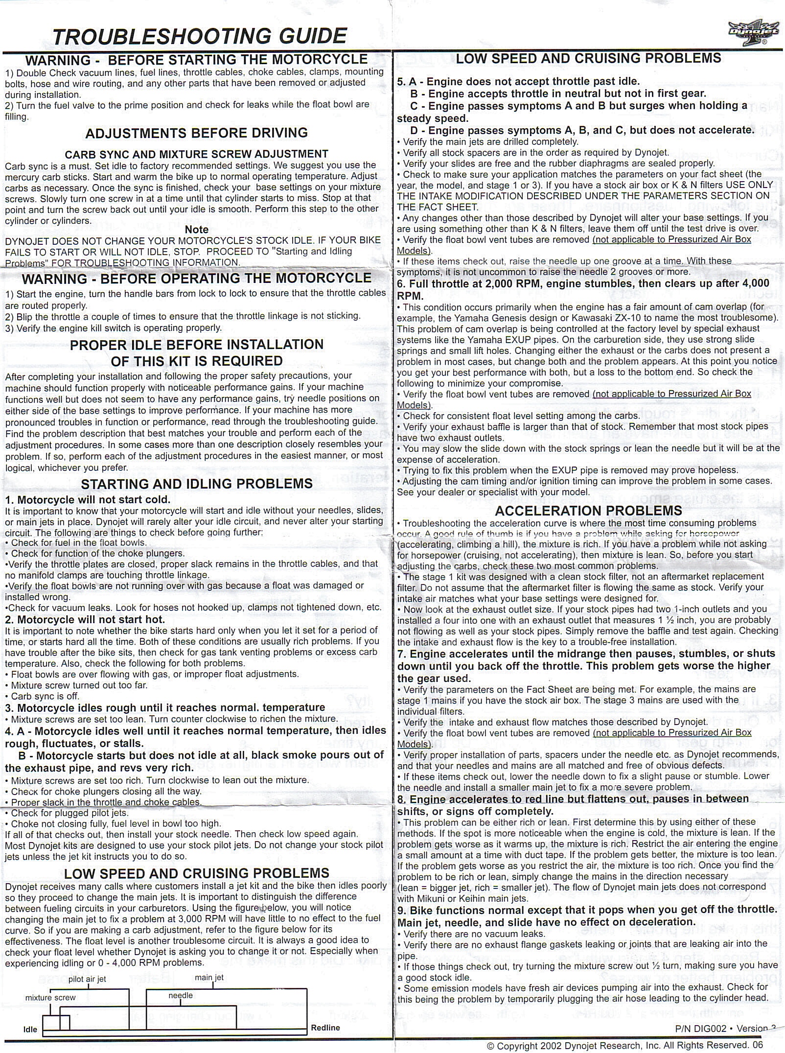

1 way to find out, put the spark arrestor back in. I don't know if Dynajet makes a Stage 1 kit, but if they do, you could play with rejetting. Once you know what the stock jets are, you can try a couple richer pilot and main jets. Check that the neoprene diaphragm is seated and has no tears or leaks. Lastly, if you play with jets, it's safer to go rich than too lean. hope tis helps...
