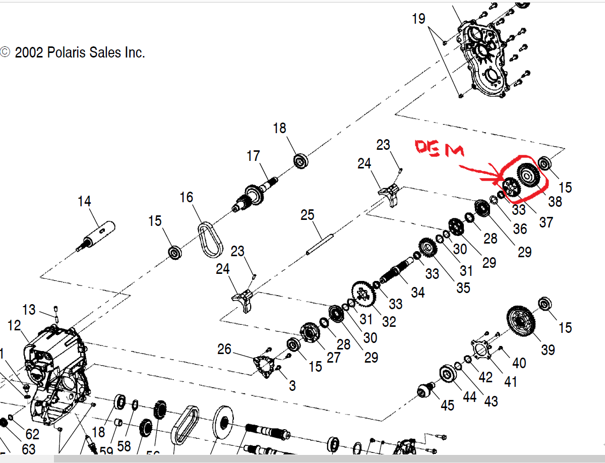

High gears in my ATV doesn't work at all, the reason is demaged high gear (pt. 37 number: 3233912). I need to raplace it, but the bigger gear is something like welded or pushed very hard (?) into shaft so i can't remove it ( i mean gear 38 : 3233971).
So, there is my question, how to remove the biger gear? With hyraulic press? Or heat it up and try to do something then?

The gear should just slide off,but you can heat it and see if that helps.Those little wave washers can weaken over time and cause shifting problems also along with the outer shift quadrant.You might want to look over it also as this guy did on hard shifting problems.Hard to Shift 700 Sportsman 2004 - Polaris ATV Forum The most common problem on the rear brake(if the caliper seals are ok) was the small rear master cylinder. Seals would harden and suck air because people didn't use the rear brake that often.You can get these aftermarket master cylinders cheap.Not sure about your location. Even with shipping should be cheaper the $110 oem master cylinder.New Rear Brake Master Cylinder Fits Polaris Magnum 325 330 500
So you said that gear 38 should slide off, but you mean slide off with little help of hydraulic press or just slide off with bare hands?

May take heat and a press to get the gear off if it's really tight. Not sure if you can use these sites on parts or not,but better if you can than trusting ebay on a lot of items.Polaris ATV Parts

I think I can make things easier for you. Polaris Parts for your machine shows the part number needed. Scan over to the right on USAGE and click on it.It shows what machines (if any) use the same parts. Helps if you're tracking down used or even new parts. Here's an example on the rear caliper piston and seal kit on your magnum and what other machines use the same part. Here's the site.Browse
