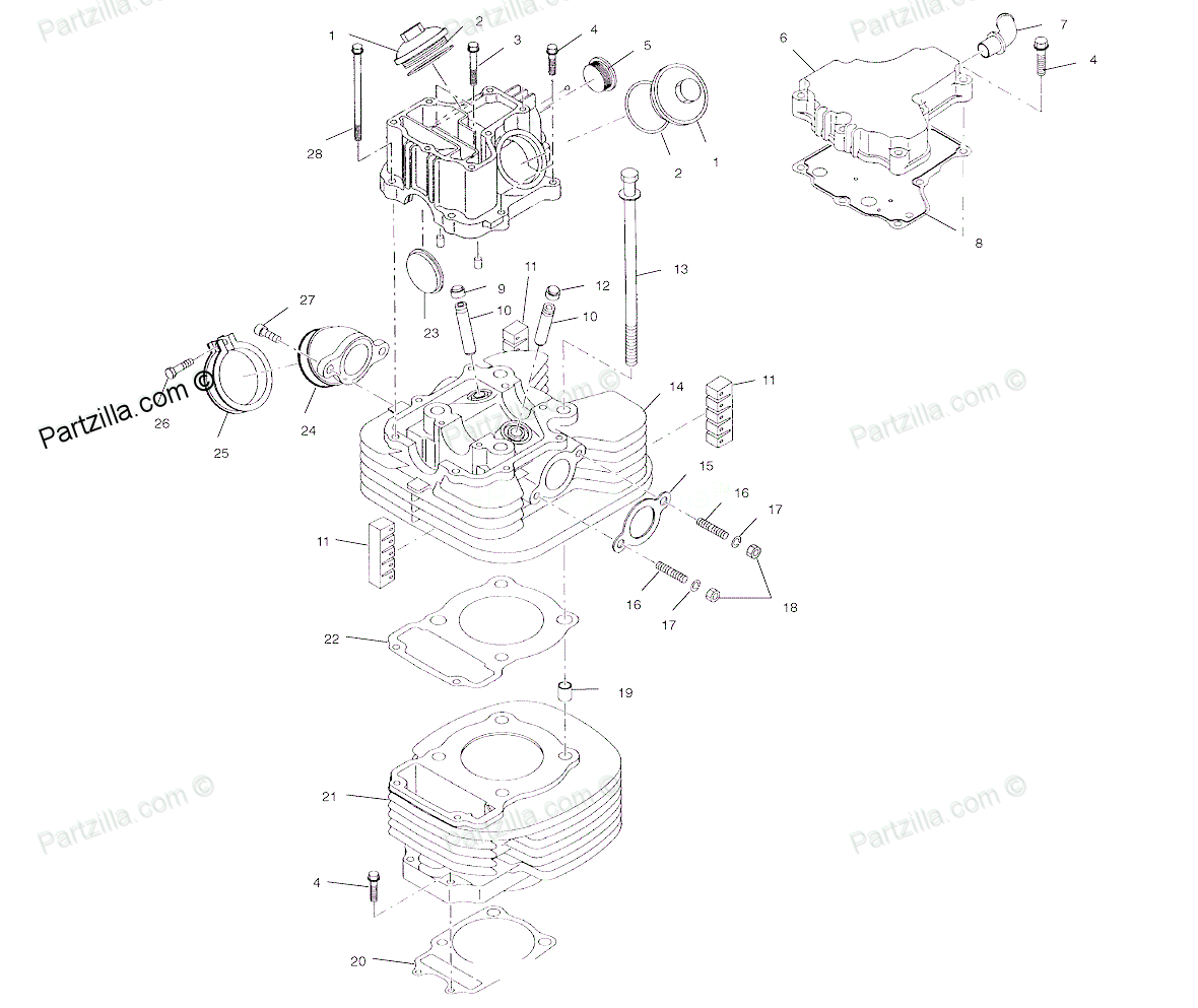

Check that the crank case vent line isn't kinked or stopped up from the breather cover leading to the air box.May have been pressure build up or the valve cap may have been loose in the first place. You can't lightly put the breather cover back on or it will leak as you've seen. Spray the outside of the engine down with Gunk engine cleaner and wash off the oil. Get a new gasket for the valve cover. Item#8.
Attached Thumbnails Polaris valve cover blown and fluid leaking from exhaust-6b7671939cce039f1468c25ec2b2e5fd4432ad75.png

If the aluminum valve cap is stripped out then get another one along with a new o-ring.Just snug the new one down,don't crank down on it.I'd still get a new cam cover gasket,then see how it does.If when the engine is clean and dry and you have white smoke from the muffler,that could either be valve guide seals or blow by from the piston rings. This is where a leak down test would come into play. Same principle as what was done on this lawn mower engine.
