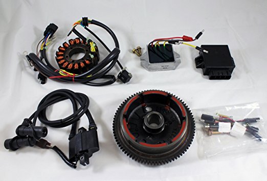

The Kokusan kit is a direct replacement for the Ducati system. Comes with stator,flywheel,cdi,coil, regulator,jumper wires needed and instructions.
