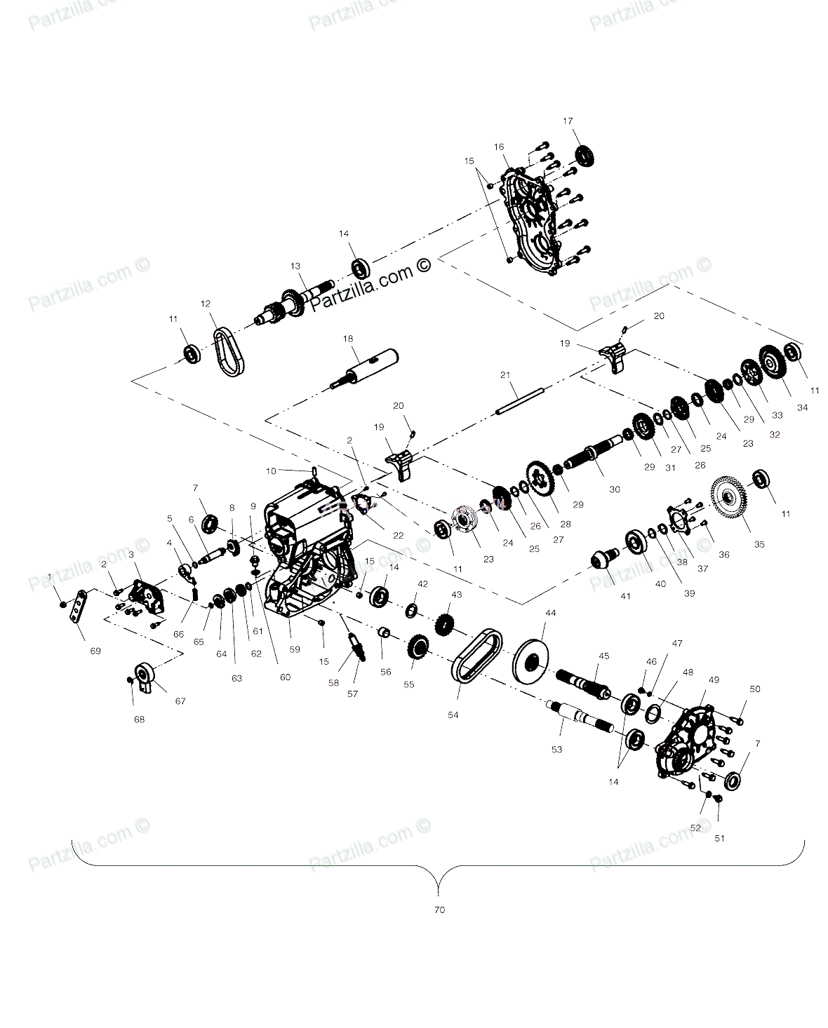

Could be either one of the two silent chains making noise,gear or bearing whine. Not worth tearing a gear case down for this.One of the few times I suggest trying an additive and I seen what this stuff can do as far as quieten bearing and gear whine.It's been out for many years and a lot of people seem to like it.May help quieten things down a bit. http://www.opmustang.com/store/p204/...ate_-_MGC.html I'd drain enough gear case oil so you can use the 6 ounce bottle of BG high pressure lube
