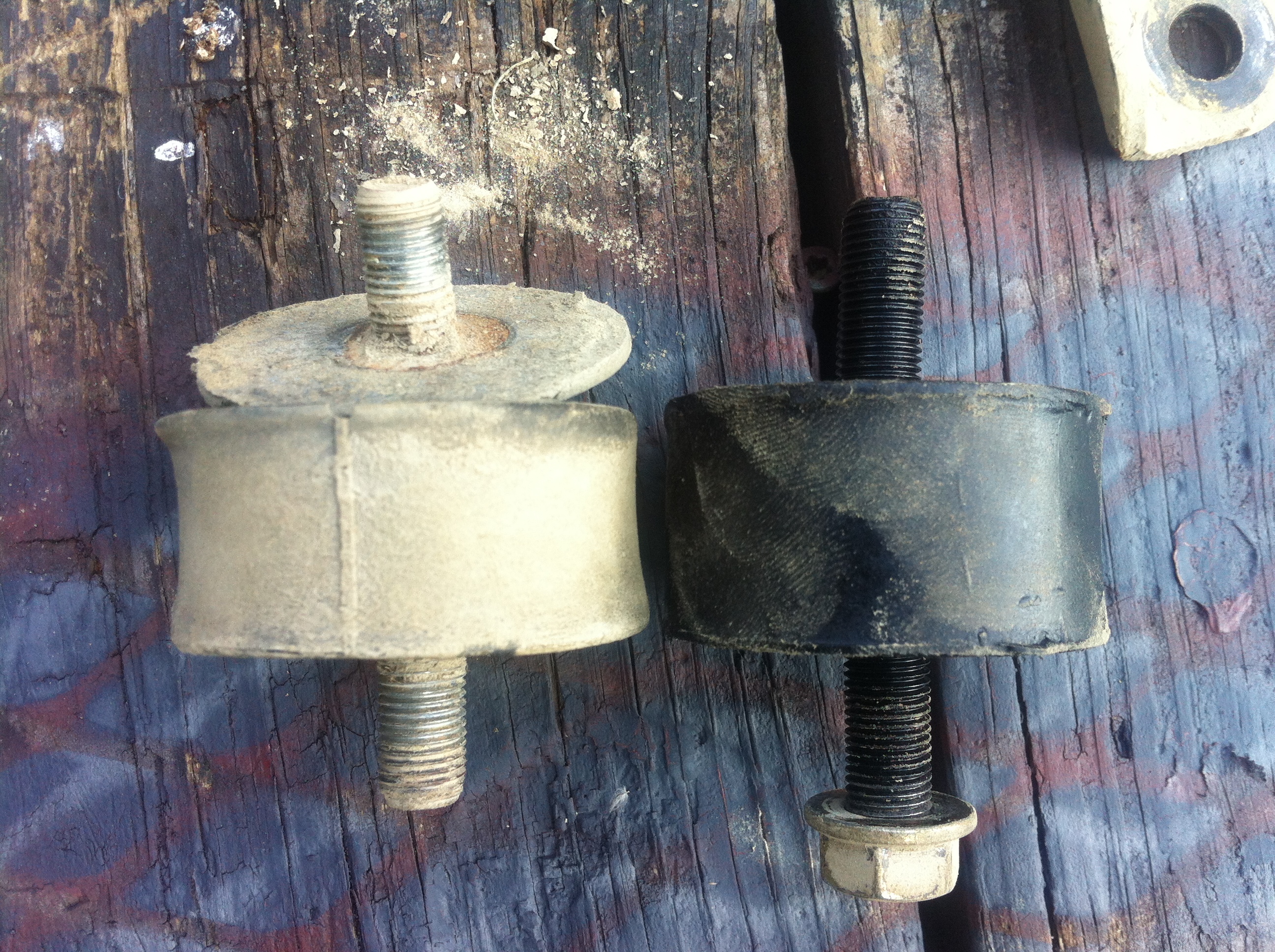

Where at the motor mounts do you see them going bad?? I will have to check that as well, but I would think that their would be some extra vibration with that. Also when you replace the copper washer with the steel ones, should you use 2 or just 1??

Front engine mount(#38) is the most common one to separate or get soft and weak as it takes most of the torque stress from the engine.The engine can flex a little which can cause clutch/belt problems also. Simple pry bar test by pulling up and pushing on the engine from side to side. They can be broken and you may not know it as each side washer and bolt are molded into the mount. Top and rear mounts usually don't give that many problems. Use 1 washer under the cup,slide it up against the one way and see if you have side to side play. That may be all you need or you may need 2 like the original poster used.

Okay Got the primary apart. No PTFE washer at all. The one way ground a ridge into the sheave. can i lightly grind the ridge down or am I screwed?? Also the brass washer is worn paper thin; Not really cupped but paper thin. So the part number in the other post for the steel washers was 7556401; However they are too small for my shaft and wont slide on. Do you have the correct number? Also the engine mount passed the test, It's still good.
