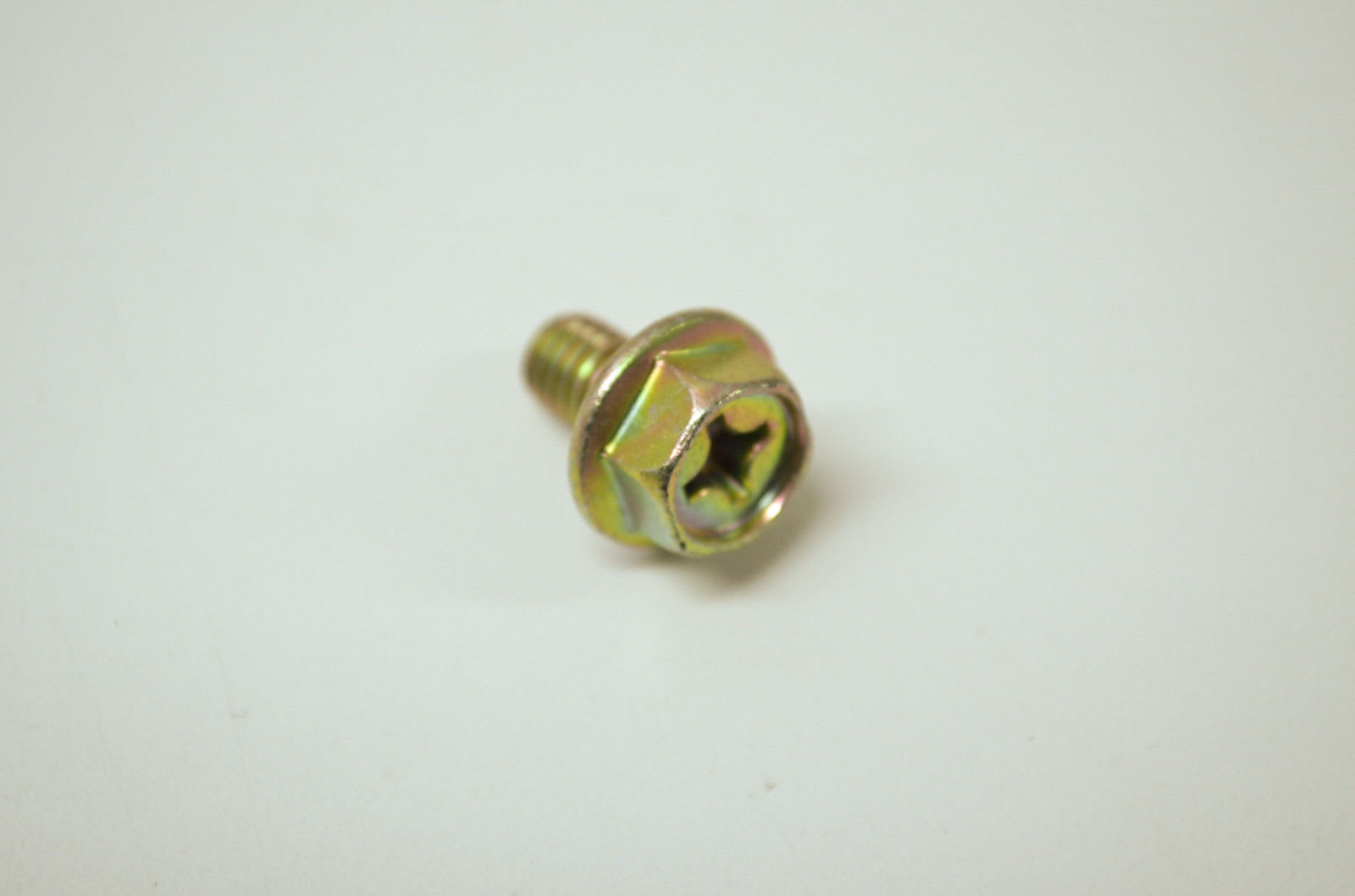

the head of the bolt broke clean off with minimal force. Must've over tightened it last time, or it corroded out. Both seem likely. Any advice on how to get it out without having to drill things out? I had it out a couple months ago, when the great flood happened, but other than that, it has been un-touched.

Update, got it out, it sure did break in an interesting manner.
the gouge is mostly how it was when it broke. After doing a bit of tapping with a wrench and a hole punch, I was able to free it up enough to use a small flat blade screwdriver to get it out. I don't have anything like this laying around, is there a specific part number I can use to get a replacement? Also, any ideas to how it broke in this manner?

You're very luck on getting it out.Probably broke the head off because of being too tight. Only takes about 5-7 foot pounds torque which is just snug. Polaris part # is 3083767. You can order one from Partzilla,ebay,etc or match this flange head bolt up at any good hardware store. Think it's a 6 mm 1.25 pitch threads.
