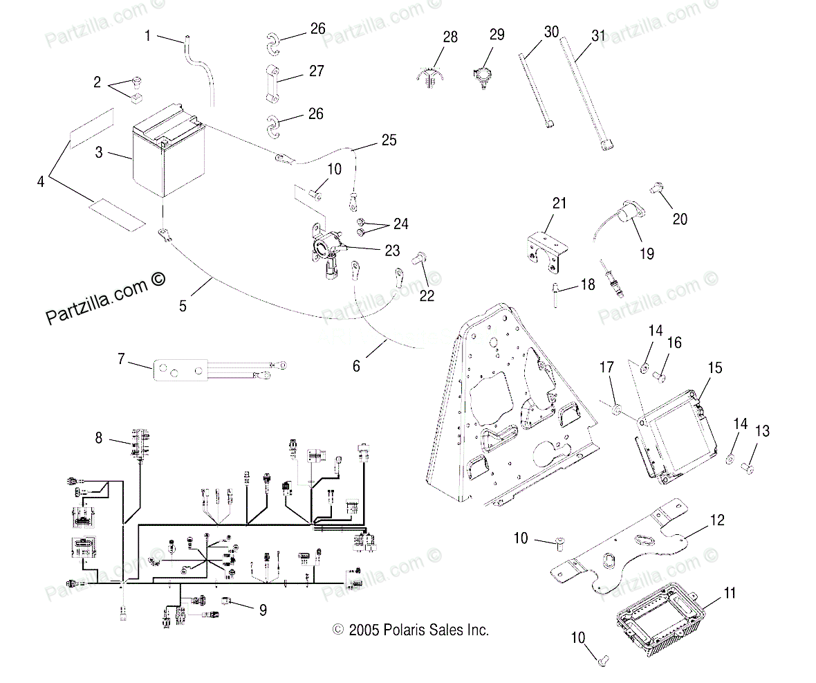

Pull the speedo connector and use a little electrical grease.If the speedo continues to black out it could be a problem with the pdm module.This module has all the circuit breakers and controls power to the dash, starter,fan,etc. This model was prone to have pdm problems I really believe because of where it was mounted. Right at the front. Item#11 on the parts break down.If it continues doing this,the manual does have a few tests on this module that you may be able to narrow it down to either the pdm or the speedo itself.2006 Polaris Sportsman 500 EFI Service Manual PDF Download
