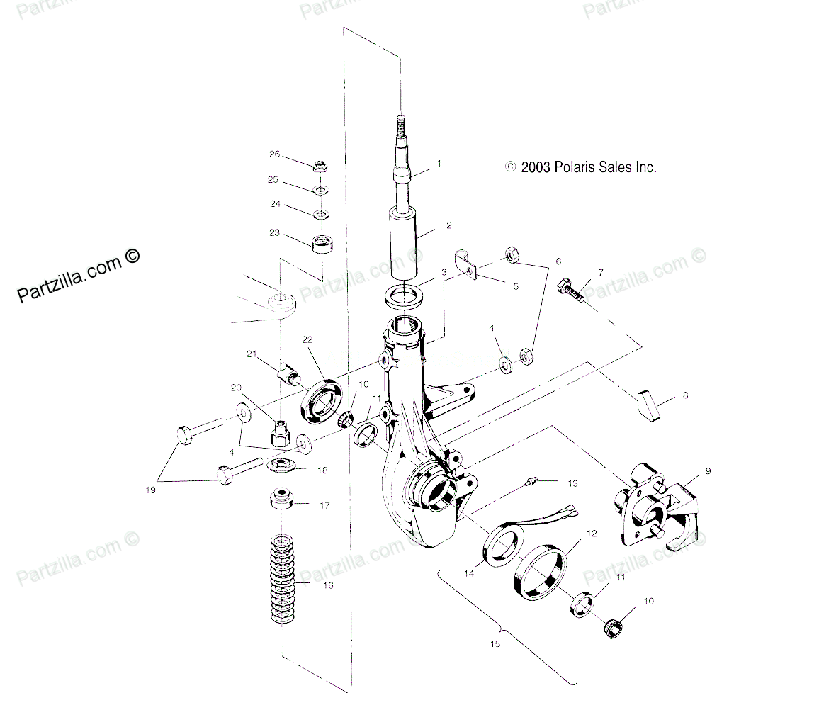

Either an electrical or mechanical problem. Check that you have voltage on the strut coil gray wire.If you have voltage,make a common ground on the awd ground wires like in this video.
If you still don't have awd on the offending side,then the problem could be a weak or damaged coil, coil sleeve not being able have enough magnetic pull to keep the armature plate engaged.If in doubt on the strut coil check the resistance on the gray and brown/white wires. Should be around 25-27 ohms. Inspect the face of the coil sleeve and inner pole of the strut for damage also. If these are ground down awd won't engage.

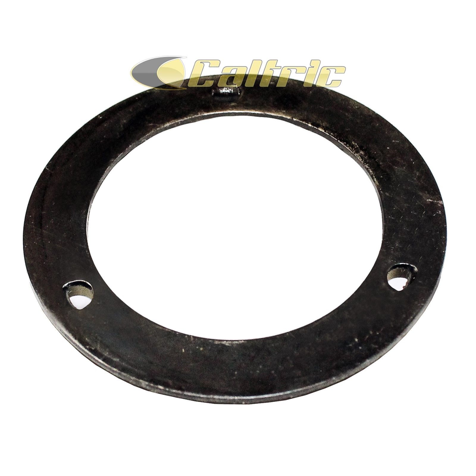

On not being able to disengage,usually a magnetized or worn armature plate is the most common problem. If the plate sticks to a small screw driver,replace it. Do both sides as the other side will usually do the same thing a little later on. Cheap parts but they are important. About 8 bucks each on ebay or amazon. Get the cheap 5 buck manual. It goes into detail on the mechanical and electrical functions on the awd system.http://polaris-atv.brssm.com/2000-Po...ce-Manual.html
