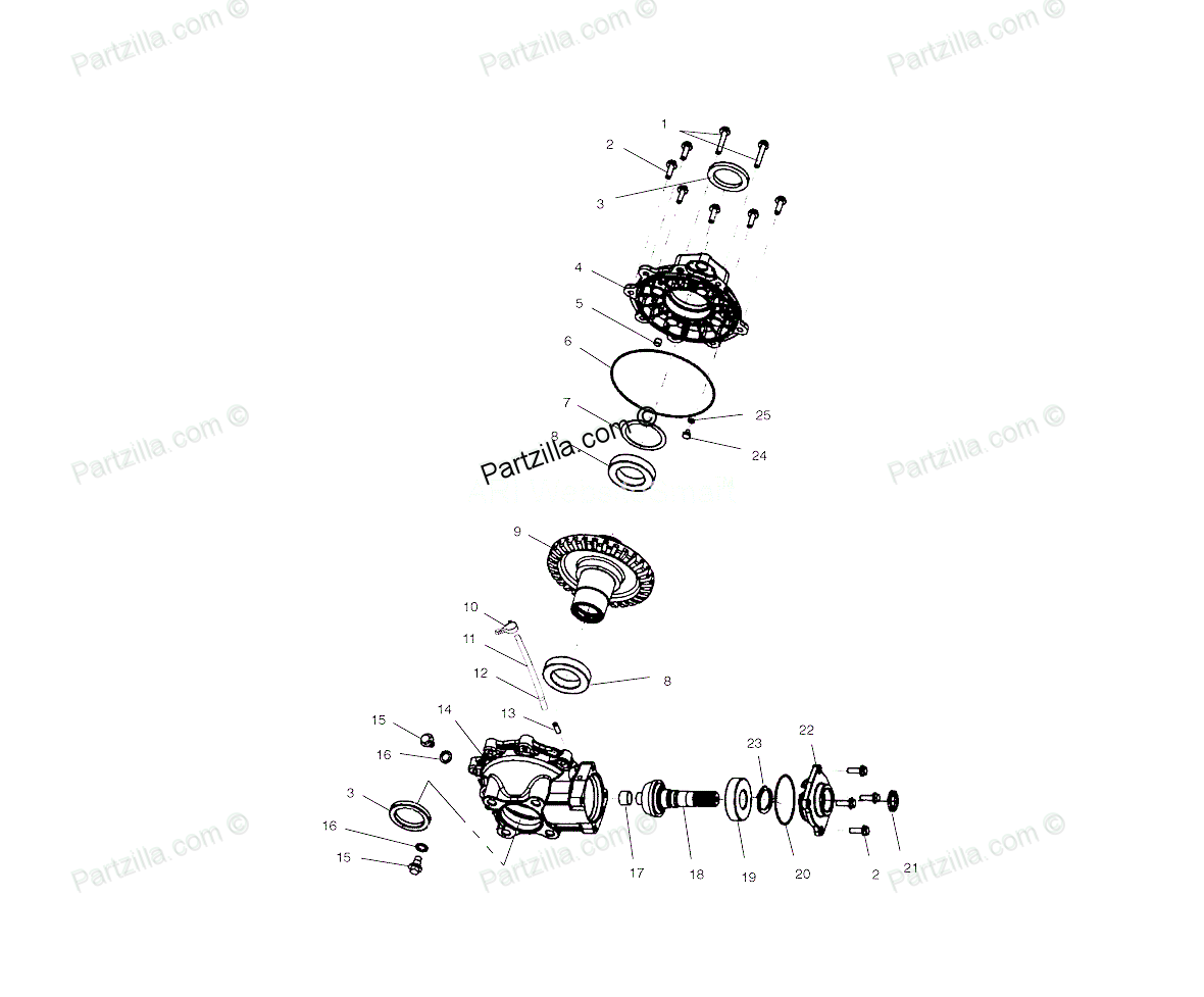

I've had to replace a few of these couplers on the 325 and 425 Magnum because most people either didn't know they were there or had a grease fitting. If another coupler failed I'd think the prop shaft would just grind and slip. One way to tell is to jack the rear end up,have it in neutral and try to spin the rear tires. If it's really locked up,this could be bearing or ring and pinion problem in the rear gear case.Other wise the wheels and prop shaft would turn under normal conditions. This was another item that a lot of people let go dry or didn't change fluid often enough.

Easier to just leave the rear swing arm in place,remove the caliper,pull the left drive shaft yoke and other parts to be able to pull the drive shaft out. Then wiggle the diff out from the prop shaft. Parts break down shows enough how to take the rear diff apart along with the pinion shaft.

If the prop shaft splines or the rear diff pinion splines are worn down,the wheels may turn ok with the new couple while in the air with no load on it. Under a load the coupler may still slip at either place.Inspect the splines closely.
