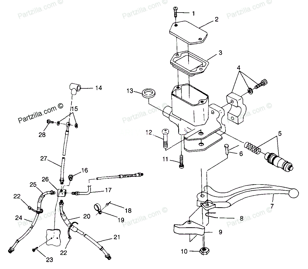

Either still have trapped air in the lines or the master cylinder piston seals are worn,sucking air. Clamping/restricting the hose can help build up pressure in the master cylinder but don't trust something like this. If you're sure the lines are clear,mity vac works the best at this,the oem piston/seal repair kit($81) costs way more than getting an after market master cylinder.http://www.ebay.com/itm/Left-Brake-M...pZQ28n&vxp=mtr
