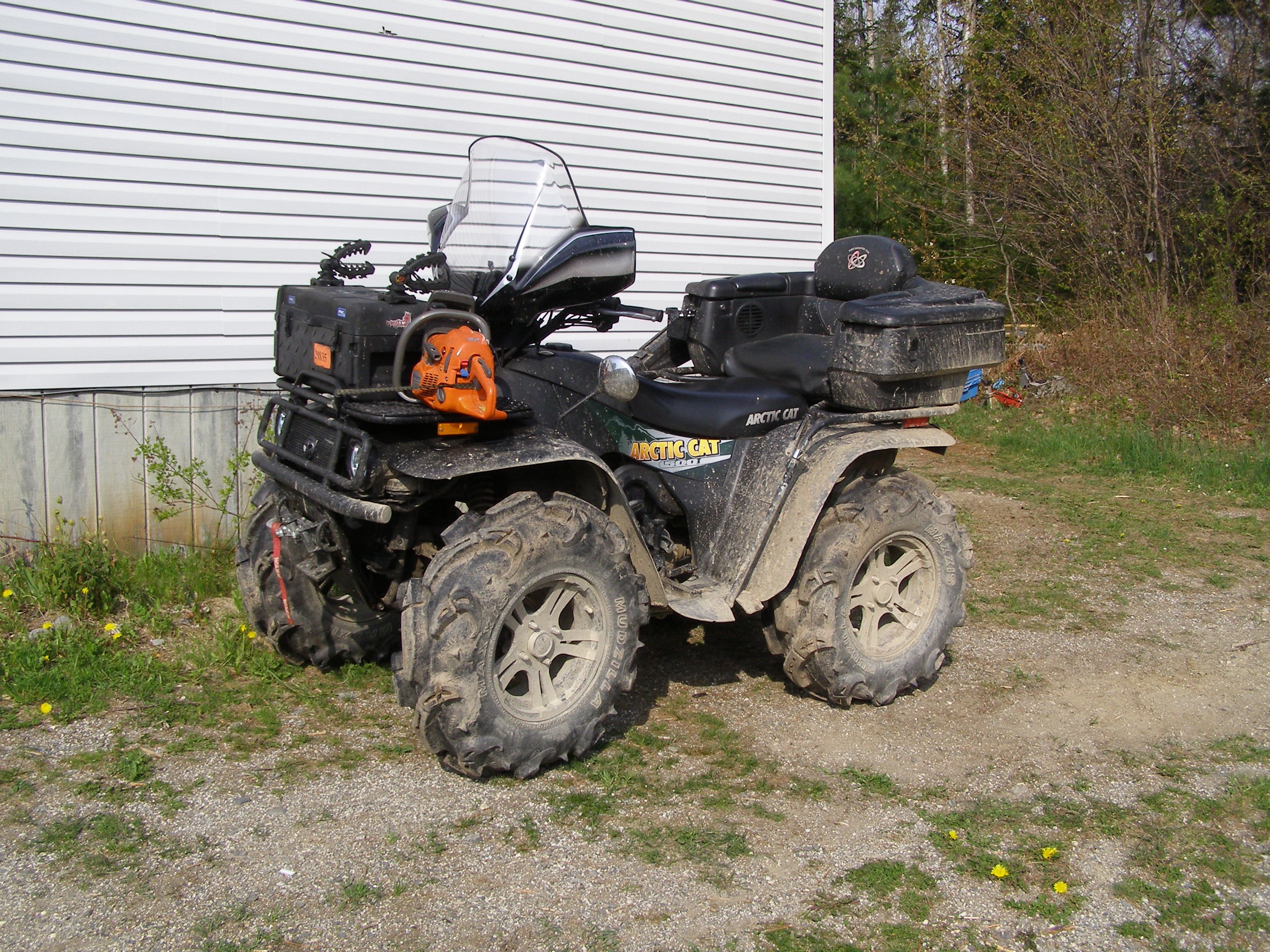

I installed a Wes Industries rear seat/box on my 2001 AC 500. Was very easy,need a cordless drill with 1/4" drill bit and a 7/16" socket/ wrench. Have someone help you hold it centered while you drill for u-bolts. Bit of a PITA to get the u-bolts up thru, might need someone with small hands. If you ride 2- up on a regular wheel base ATV, be very careful. Going up hill, you can flip backwards easily. Also realize you have a lot of weight, with 2 people, above center of gravity. I use my ATV's to post bear hunters to stands, so, I now have 2 AC TRV, long wheel base machines. Much better with 2 fat guys on board, hehe.
