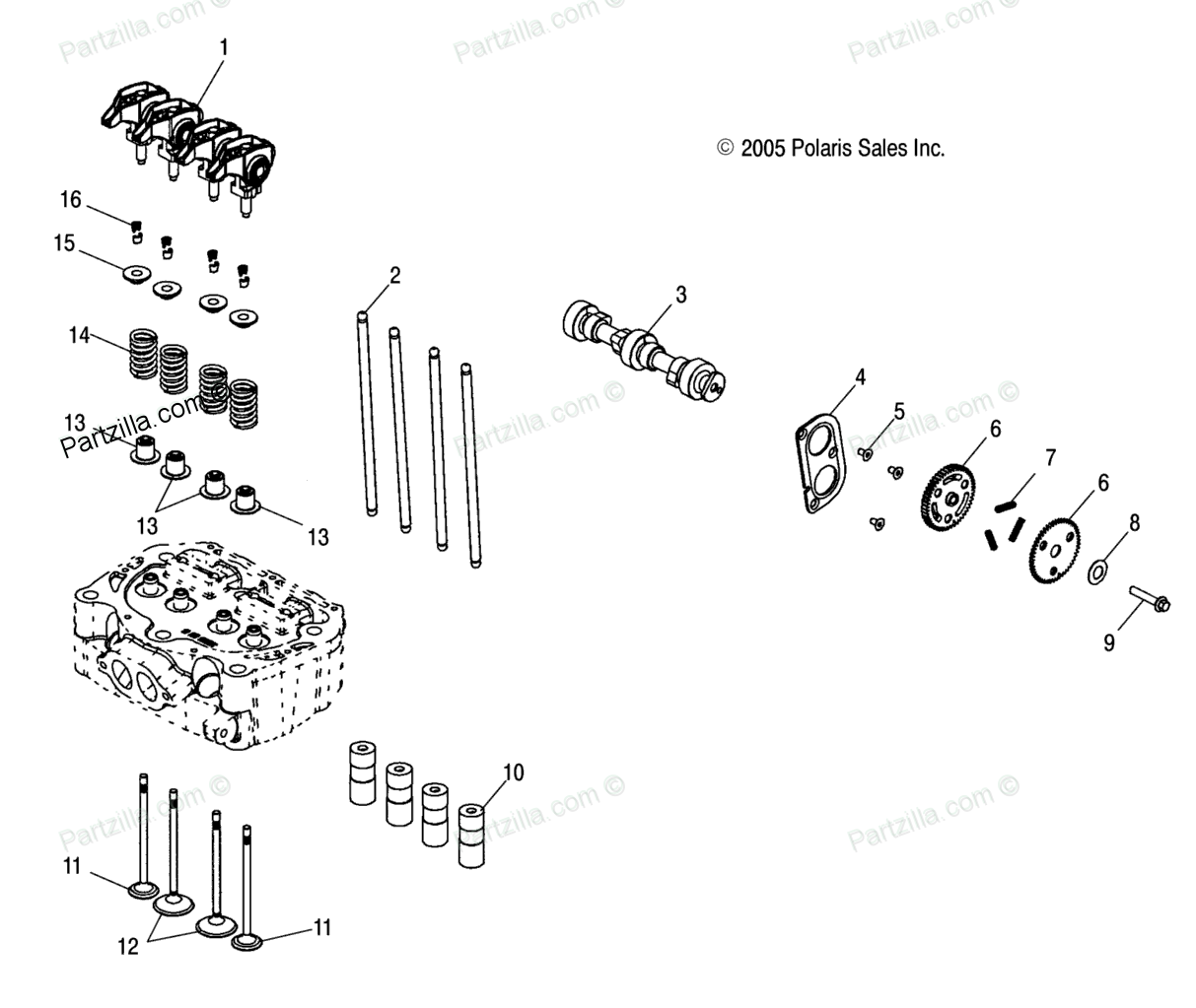

Appears you have the late model 2003 that had the 2004 updated ignition which is good to know. If it's really worn,you can get the jet block for around 34 bucks. If the diaphragm and slide are still ok that's the way I'd go before I bought a cheap Chinese knock off carb that may or may not work right.Cams weren't normally a problem on the 700 as they were in the center of the engine.Has a push rod system similar to auto engines. For tear down and assembly can't beat a good manual that has pics,step by step instructions and torque specs. Namura is the only piston I know of that does have oversize pistons for these plated cylinders.2003 Polaris Sportsman 700 Service Manual PDF Download
