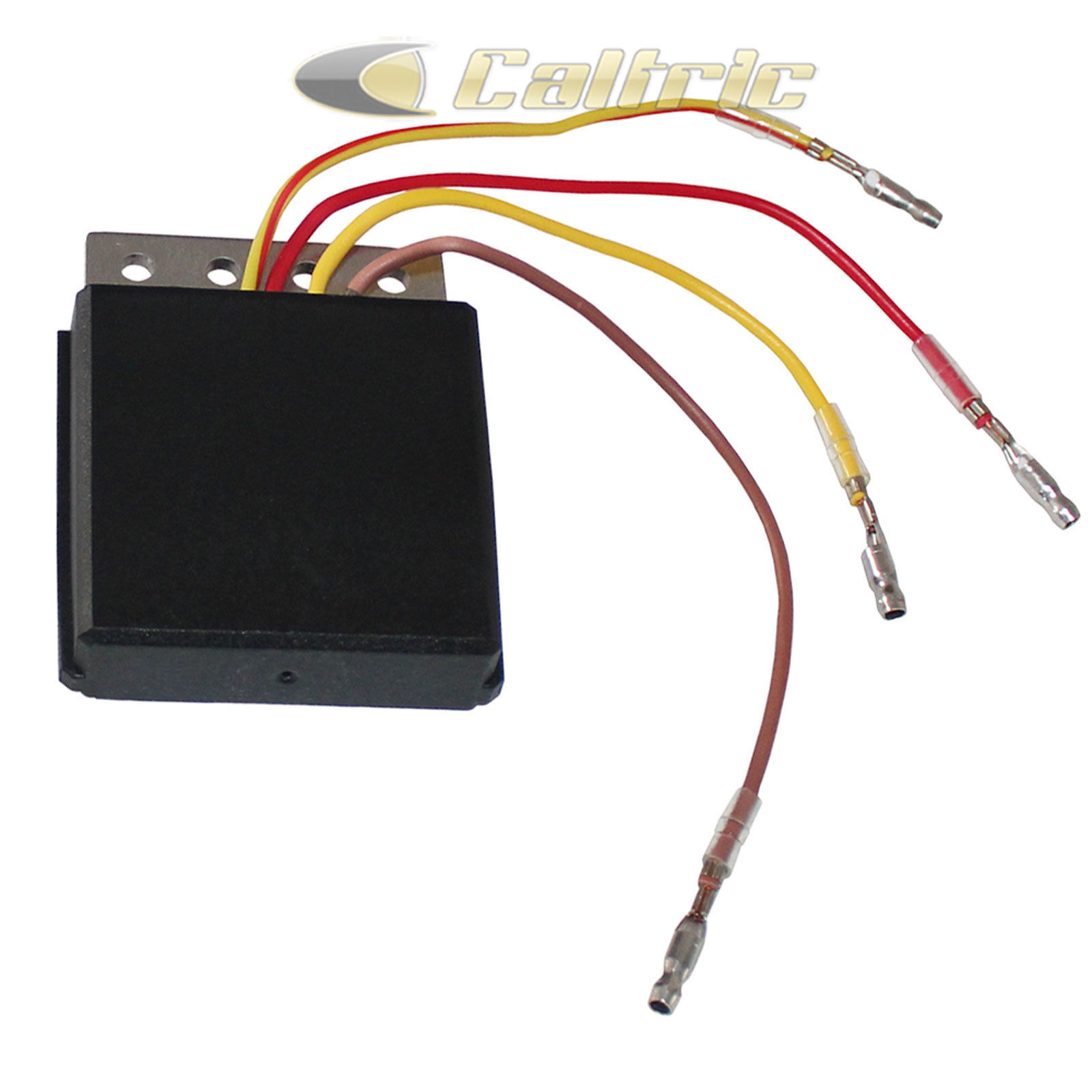

2 stators,new cdi,coil. Plus have you checked/replaced the regulator? These can sometimes interfere with ignition if faulted.It,the wiring harness,ignition switch and left control switch are about the only things left you haven't replaced.

Simple thing to do is unplug the wires to the regulator and see if you have spark either with the cdi kill wire hooked up or disconnected.If you eventually need a new one,these are cheap on ebay or amazon.Part #4060173. https://www.ebay.com/itm/Rectifier-R...pTmdAL&vxp=mtr
