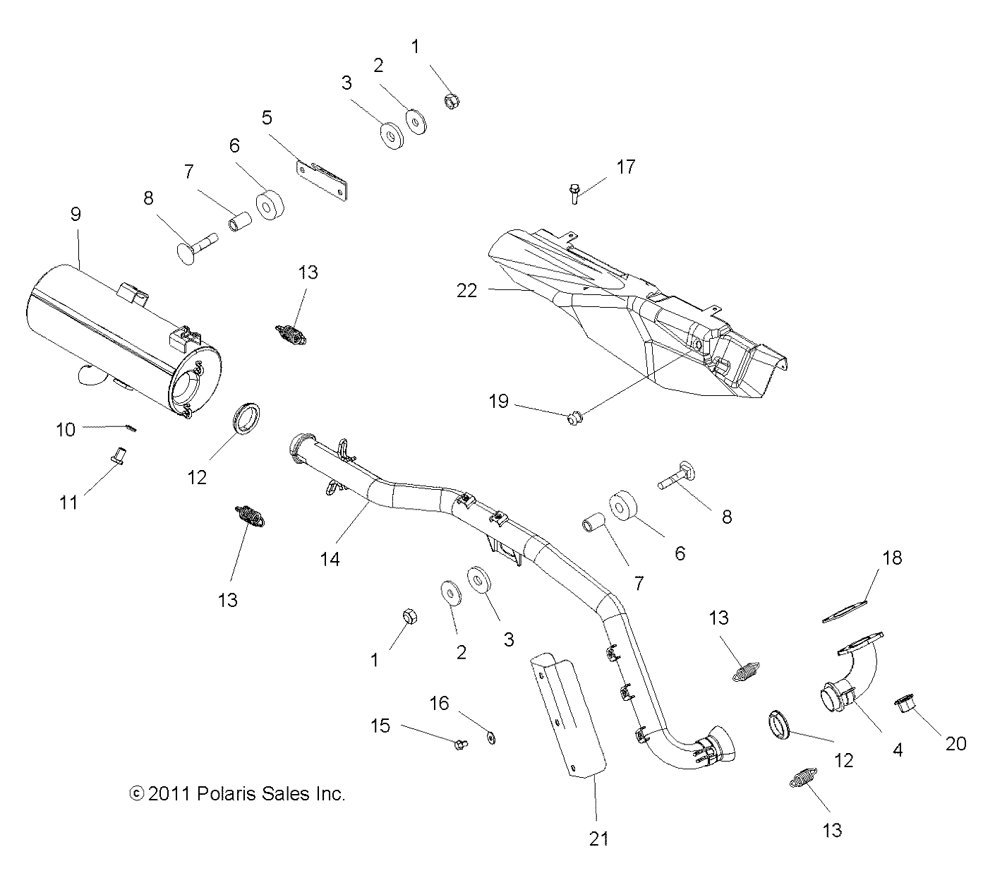

Don't know if rust remover would help,but kerosene or naphtha would clean up the muffler from a lot of carbon build up. They still show to have the clean out plug same as the older ones have.Clutch kits are still the cheapest way to get a little more umph from an engine. You may lose a little top end but most people aren't concerned about it.https://www.highlifter.com/prodcat/h...clutchkits.asp https://www.speedwerxstore.com/index...duct_list&c=83
