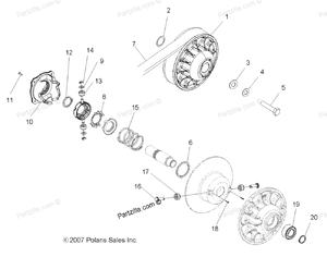

Most clutch kits use stiffer springs,heavier counter weights. This takes more throttle to activate. Several people that I've installed kits for didn't like them and had me change the clutches back to stock after riding them awhile. You can get oem springs and weights(if they were changed) fairly reasonable at Partzilla and other online sites.
Attached Thumbnails 2008 polaris sportsman 800 twin efi awd issue-c999e5b0a22bee74378eebe4a58d7641fce1d6e1.png   2008 polaris sportsman 800 twin efi awd issue-cd3a742430cb91db205caf9dc567d318167f67c2.png

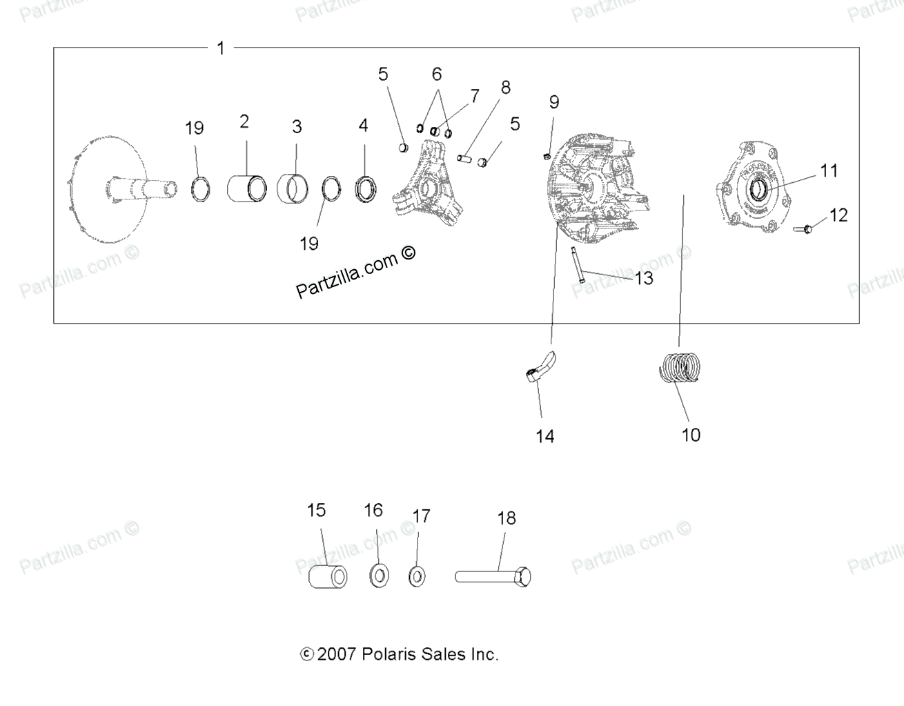

Clutch kit or may not have anything to do with your awd engagement. Change fluid first if you haven't done so already and see if it helps. Most common problem or the weak point on later model awd systems was the plastic roller cage and armature plate wear. Even small hardly noticeable cracks in the roll cage could affect engagement.If you're having problems with it and have to tear into it replace the roller cage with an aluminum one. Polaris list an aluminum roller cage as an "option" on your model. Later models came standard with it. Item #10
Attached Thumbnails 2008 polaris sportsman 800 twin efi awd issue-8df02b61c4c07330412d997141ab3bdd9800efd3.png
