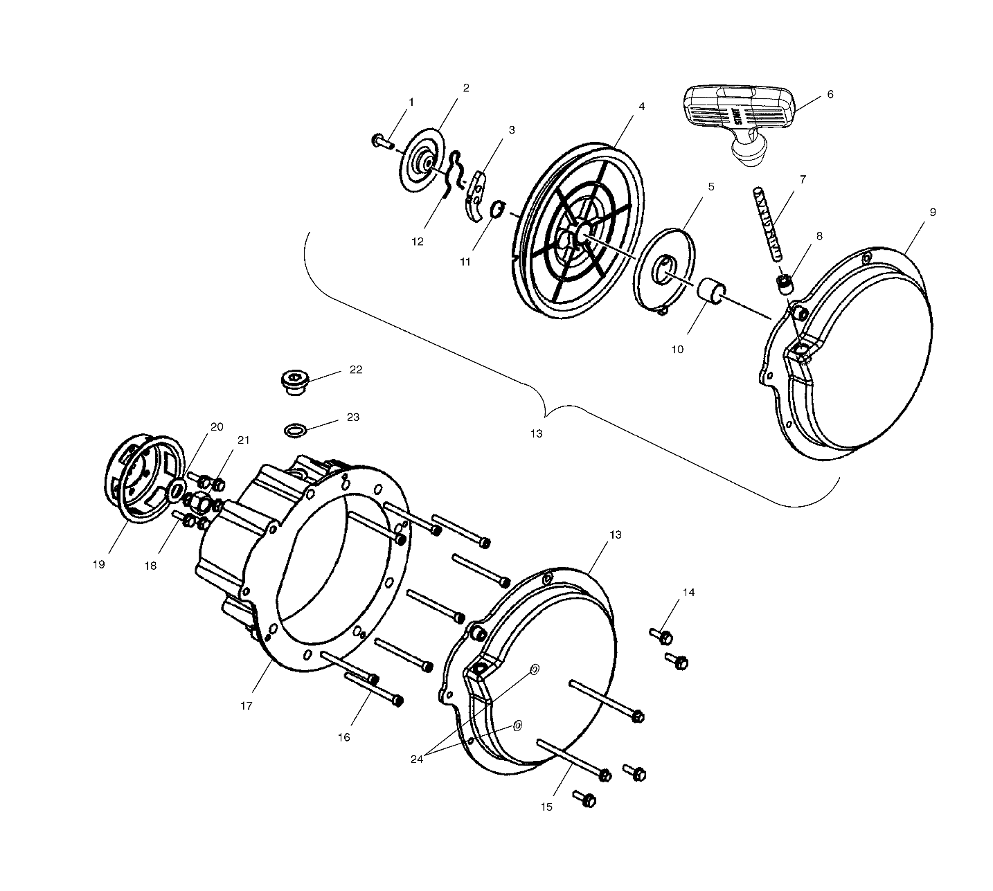

ok hears how you put a pull start on a sportsman 700
get the recail assembly for the Polaris Frontier Classic snowmobile (same motor), cut room out of your floorboard for it to fit and put these parts in
Recoil Assembly - 2003 SNO FRONTIER CLASSIC
heres parts and part #'s, you might need a new flywheel I'm not sure
1 7517984 Screw 1
2 3084744 Plate, Friction 1
3 3083378 Ratchet 1
4 5434358 Reel, Recoil 1
5 3083185 Spring, Power 1
6 5412250 Handle 1
7 3021311 Rope, Starter Recoil Housing
8 3040171 Bushing, Rope Slide, Recoil 1
9 5631221 Housing, Recoil, Upper 1
10 3084750 Bushing 1
11 3083463 Spring, Return 1
12 3083379 Spring, Friction 1
13 1202271 Asm., Recoil Housing 1
14 7516822 Screw 4
15 7517306 Screw 2
16 7517807 Screw 8
17 1202379 Asm., Housing Recoil, Lower 1
18 7516822 Screw 6
19 3040161 Pulley, Starting Recoil 1
20 7555907 Washer 1
21 7546909 Nut 1
22 5433820 Plug, Timing Hole 1
23 5411564 O-Ring 1
24 7555998 Washer, Flat 2

Yep, you would definately have to have a flywheel. The factory one has nothing for the recoil to get ahold of. Flywheel The problem would be finding one that fits the 700. It may be something that could be borrowed from another Polaris or maybe snowmobile also. Good idea though, I know alot of people have a hard time with not having a back-up starting system.

flywheel off the frontier snowmobile should work, also it shouldn't be any harder to start than the frontier snowmobile, its got the same engine so if they got it on a snowmobile and no ones complaining, i mean honsetly think about it...
