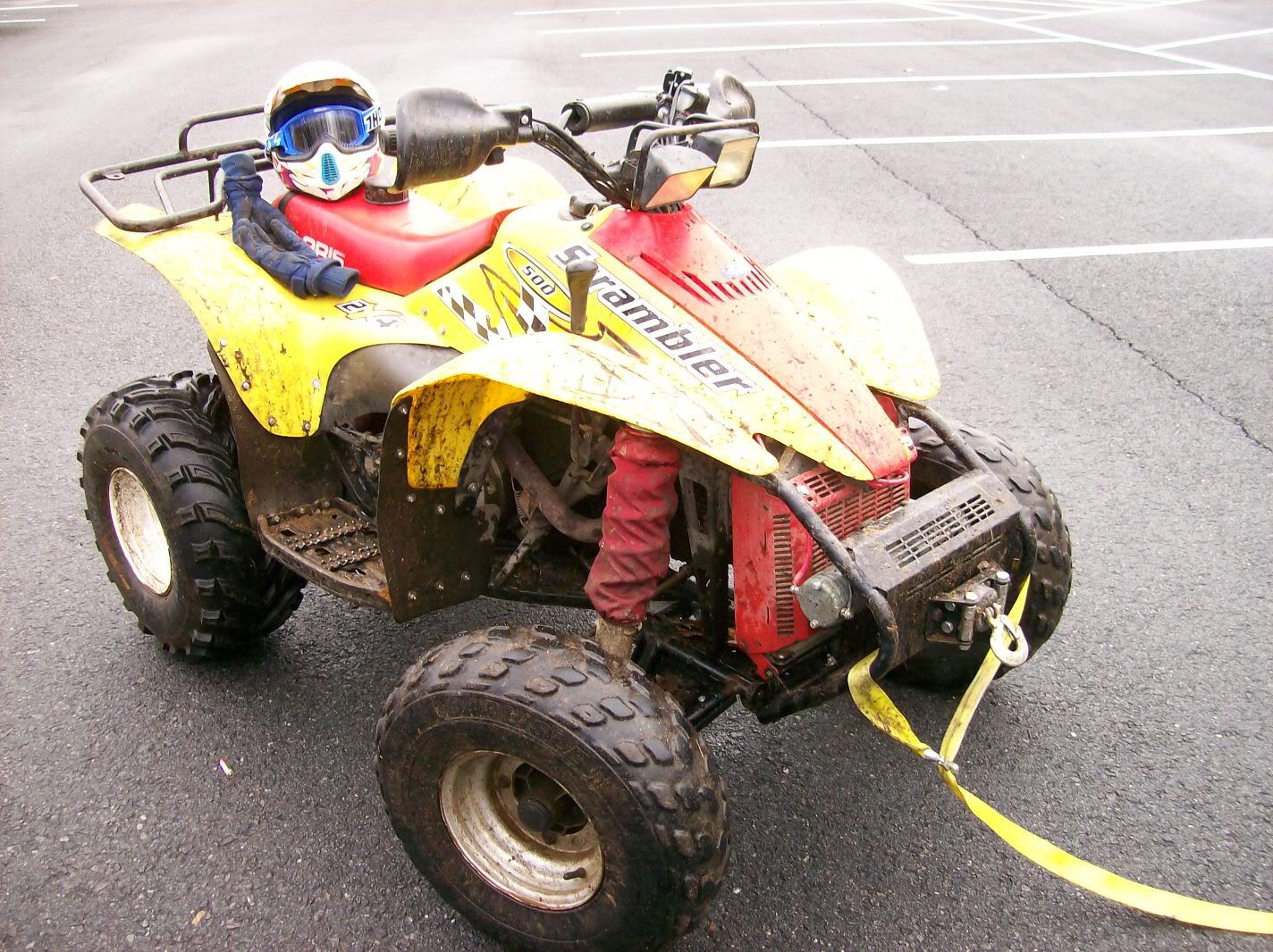

Of what I am reading on what your scrammy has on it. Looks like you got alot more weight on your machine between the over size tires and winch. It looks like you have been landing with your nose way up in the air.
To stop the crack from spreading. Take and drill a small hole on both ends of the crack. That will help stop the crack from spreading. Then weld it back together. Make sure you have a really clean spot to weld on.
What type of welding are you doing? Stick, mig or torch. If you use a mig, make sure you have argon with it so you can get a clean weld.
that is alot of weight coming down on these welds. Also, where are you located at? Looks like some rust possibly has apart in it.

ok thanks for the info. I broke the first one without the winch and mount. and i only weigh 120 lb cuz i am 14 and we are doing the wirefeed i am acualy having my kind neigbor do this and yes he has the gas and everything needed. and yea
the first time it broke it did land hard on the back somewhat it wasn't close to throwing me off or anytName:  100_1470.jpg
Size:  312.5 KBhing thow.
