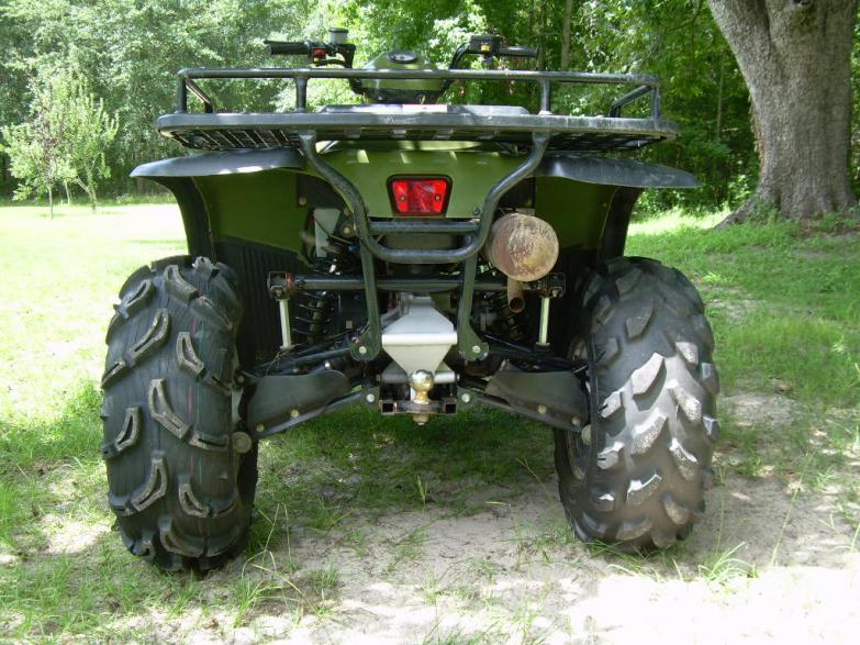

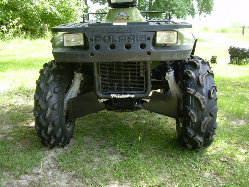

Well,the Zillas have arrived.Last night I took a homemade 2" lift off the previous owner put on and have the proper lift kit ordered so it is at stock height.Here are some pics of stock 27" Zillas compared to the 25" stock tires.I would had like to have went bigger but I hate to sacrifice too much power plus the extra $$$,the tires are super light.I've got a ton of work to finish so I hope I can get the other side on and see how they ride late this evening
