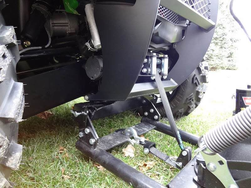

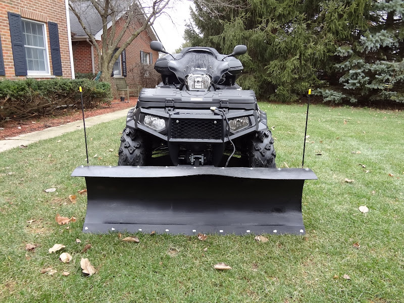

Here are some pictures of the Warn ProVantage with power pivot installed on my new XP. The Guru bumper is a special version made to work with the plow mount. Everything fits together like OJ's glove! Now all we need is snow!!!

The mounting plate that stays on the quad looks awfully low. Does that stay on the quad or is there a pivot mount higher up. Otherwise looks like a great system. Nice to not have to get off the quad to change the angle.

You loose about 2 1/2 inches from the bottom of the fang. One nice thing about the mount is that with my impact wrench I can have it off in about a minuet if I am going on a trip where clearance may be a issue. During the winter months I usually trail ride in WI and that is not a issue. In the warmer months I remove it.

Sweet setup. What changes were made to the brush guard?

Changes were made to the bottom with width on mounts so the mount will fit between the bumper and atv. Also the lower bar is different so there is access to the 2 upper bolts to remove the mount when not needed.

Looks like kind of a long stretch for your thumb to operate the winch and plow controls. Is that an issue?

I prefer to have it on the top. That is on my list of things to do Relocate the mount to the top. I just need to make a shorter bracket do to the location of the mirrors.

I used the new Warn ProVantage plow with power pivot during our last storm. It did a great job. The added weight in front keeps the blade down. I love how I can change the angle of the blade with the push of a button. It really helps in getting the job done & done fast. When you are finished it looks like it the area was plowed by a pro!
