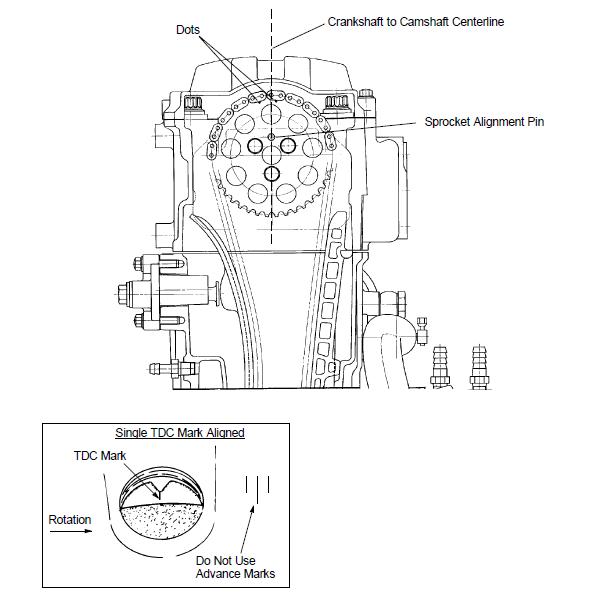

Cam chain tensioner is self adjusting. I wouldn't mess with it as the chain should be tight. If you have a new starter,new battery,solenoid as you say and the cam detent lever/spring is working properly,then I'd recheck timing to make sure everything the mechanic did is correct. To do this you need to really need to pull the flywheel,stator and cam cover to check the lower sprocket OR just pull the recoil housing,use a paint stick to high light the "T" (tdc mark on the flywheel)replace the cover and see if the cam sprocket alignment pin is center of the head and the tdc mark on the flywheel lines up with the pointer on the inside of the recoil housing.

OPT, I understand checking the timing but it runs well when I can get it started? Both idle and at 30 mph. I just can't find what is causing the ( for lack of better terms) drag when starting? Even with the plug out it seems to drag some. Will pull the side cover and look at the belt when cranking? When running it does not act like it is trying to pull or move like it has a transmission drag.... I am baffled! Before changing the cam it turned over well....... I am in Kaufman, is that near you?
