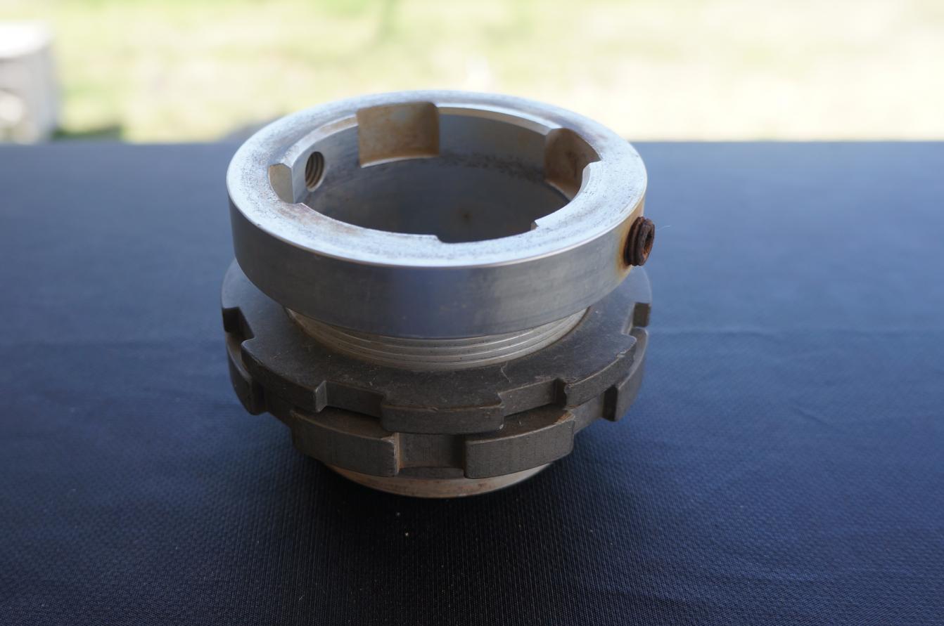

I cnecked the links.they look similar to each other like the Polaris oem ones I found.i cant really tell what they anchor to,the strut or the cartridge.does that style just lock in three different settings?the ones I have sit on top of the struts and lock onto them with set screws.its solid tubular with threads and 2 spanner nuts to adjust height.

have u ever seen this style?sportsman front spring preload adjuster question?-dsc02594.jpg

That's a new new one to me. I've seen solid metal ones that weren't adjustable but not that kind.
