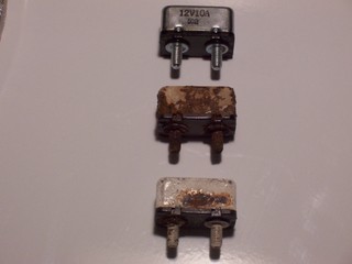

Most problems like this are left control switch related. You really can't take one apart(at least I couldn't) without having springs and brass parts flying all over,but you can spray electrical contact spray and check the wiring leading under the front cover along with connectors at the switch.Found several where the connector pins had backed up a tad not allowing transfer of power. Plus check whether you have power to the small wire at the solenoid. If you have power on this wire when the starter button is pushed,could be a defective solenoid. Plus not abad idea to slice the circuit breaker pouch open and check condition of the breaker. If corroded power transfer could be intermittent.
