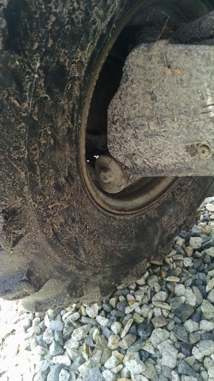

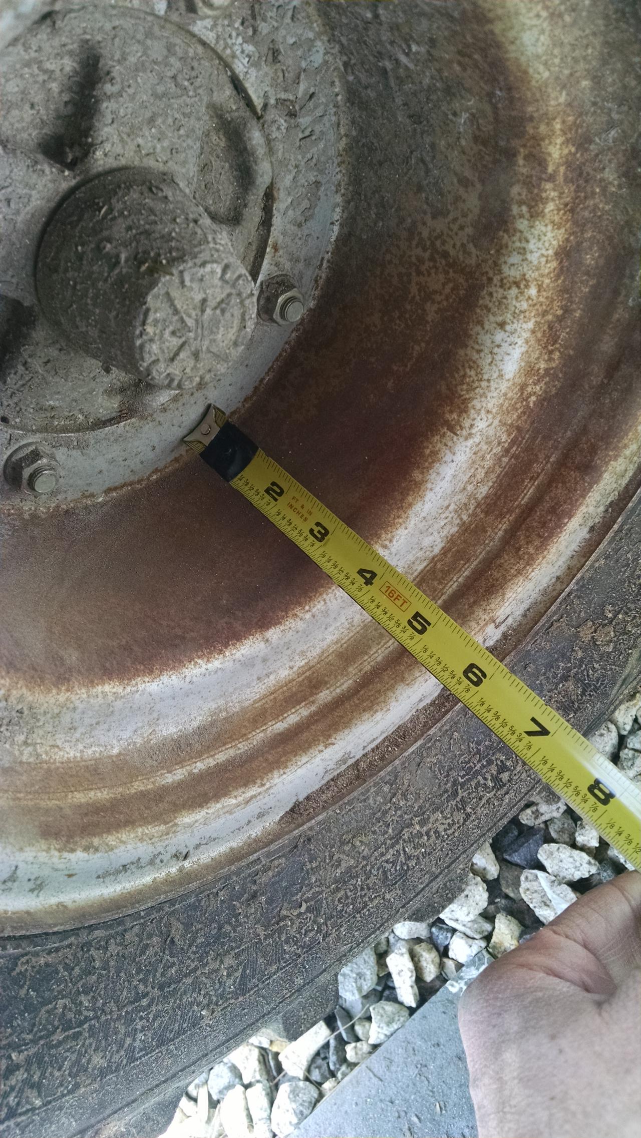

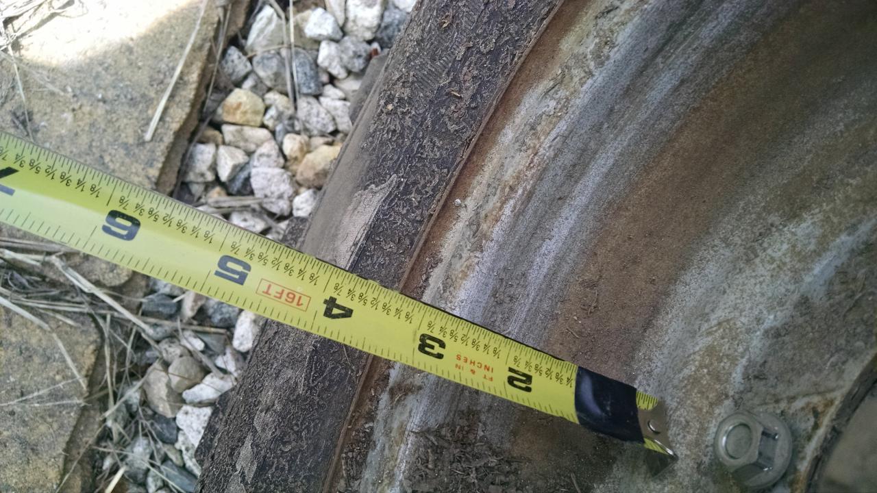

Okay if you are still with me, great! I took some pictures. I think the problem is def the rims, the offset is gigantic. I swapped one rim around, now the treads are in the wrong direction and the air nipple is on the wrong side, but I can live with that! But it does look like I have a part of the suspension awful close to the rim.
Currently, measuring from the center rim to the outside of the rim is 6 inches. If I flip the rim around, it is only 3 inches out, with the 6 inches under the ATV (which would of course reduce the overall width). The last picture shows what I believe to be part of the suspension awful close to the rim, which may or may not matter. Again, I am a newbie here...
Thoughts? Should I try running them this way or hit the bank and get some new rims and tires that are stock?

Actually, another suggestion that I had thought of making was to check to see if the prior owner had reversed the rims.....LOL, guess not in your case, their just really wide. Try to reverse them, just make sure the wheels won't/don't rub any brake parts, the valve stems to rub anything, and tires don't rub the suspension anywhere. If thats all good, and the bike feels safe/stable, you can alway drill the rims, add the valve stem to the other side of each wheel...

It looks like it would tear the valve stem off but you can turn the wheel by hand and see if it hits.
It may... But one can remove the valve stem, and pull it in backwards ( new stem ) so the stem is inside the wheel. Then drill the other side and have a valve stem sticking out.....to add air as needed. Done this many times

I agree it looks like they are mounted backwards. Looks like previous owner switched to get a wider stance for better stability and keeping out of ruts.

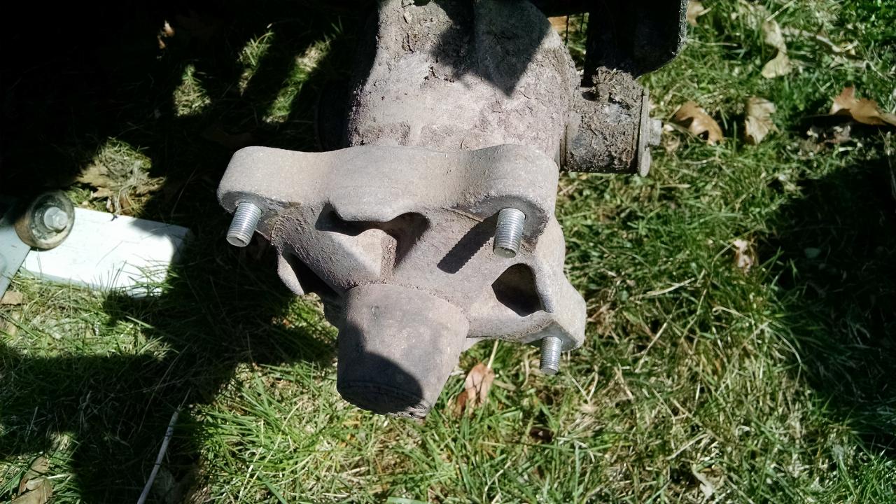

Sigh...now it looks like the lugs aren't long enough....the old rims were only 1/8 thick (approx) and the new ones are more like 1/2 inch thick. Not enough bolt sticking out to grab on to...
Options?

You can get extended studs.Had to do that a lot at the shop.

You can get extended studs.Had to do that a lot at the shop.Polaris Rzr Long Wheel Studs for Custom Rims - YouTube
Thanks! Talked to the shop, they also think some different nuts might do the job (acorn shaped) he called them. Narrow where it attaches to the wheel, and wide at the top so the socket can grab it. Good to know I have options!
