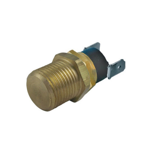

Sensor on the head is just for the hot light only.. The radiator sensor completes the ground path for the fan to kick on. Common for these sensors to short out if the coolant level gets below their level. Go to any auto store and match up a two pronged sensor to yours and wire it up to your harness for around 20 bucks or less.Needs to be a 175 degree fan sensor as the hot light kicks on at about 205 degrees. The oem wired sensors are NLA. PLUS there is a 10mm bleed bolt on top of the head close to the temp sensor. Open it up and let coolant flow out and it will also remove any trapped air pockets that can cause over heating. People forget about doing this on the 350/400 engines.
Attached Thumbnails Polaris 350 elec fan not coming on when hot light illuminated-s-l500.jpg
