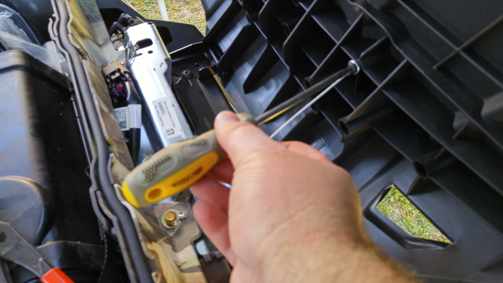

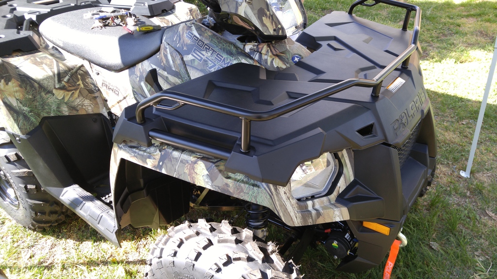

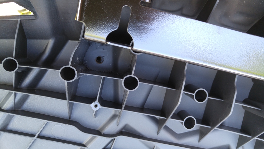

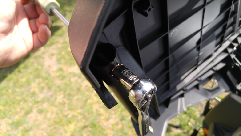

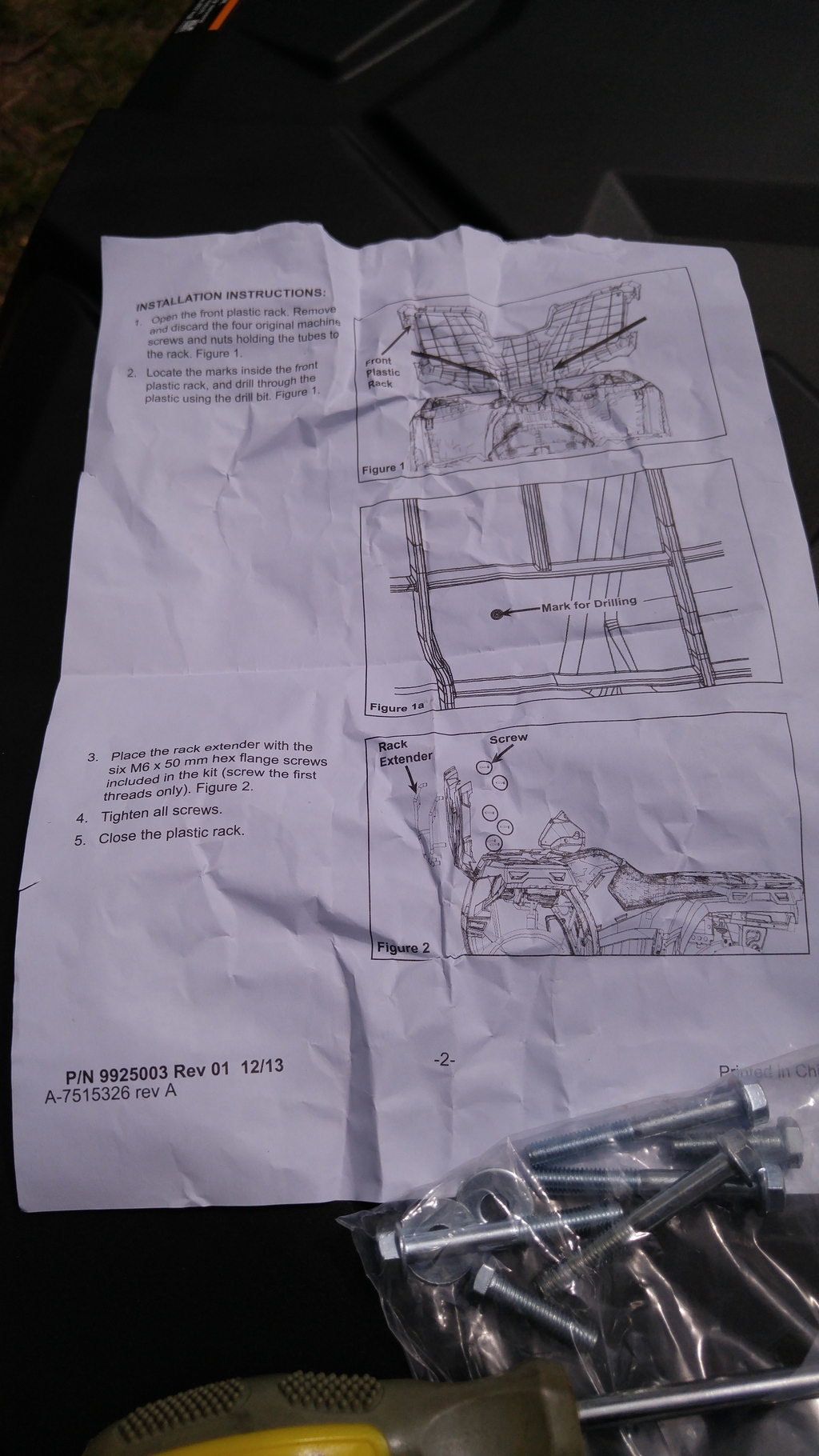

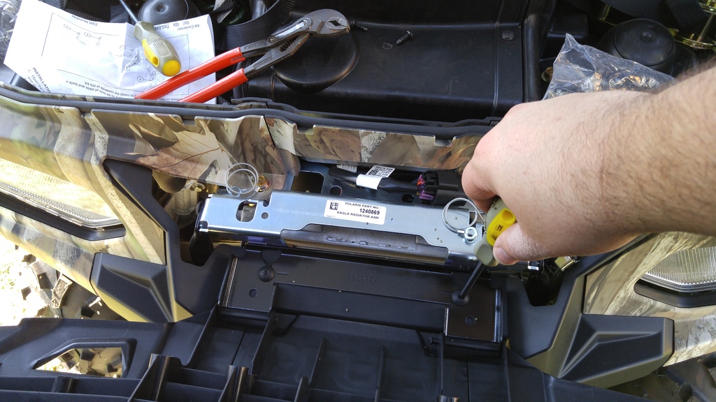

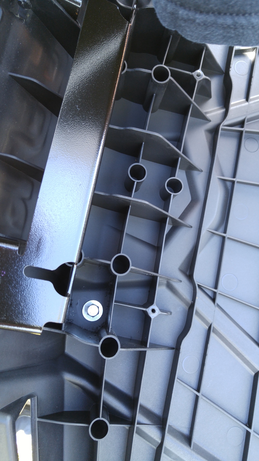

All I thought some may benefit from my install project yesterday. The newer type front storage rack does have some subtle differences from older Sportsman Front Storage Rack which was powdered coated and some different mounting design details.
Follow instructions disassemble the side bars from lid by removing screws and locking nuts. Drill a few front holes through the lid (factory mark by circles). TIP: Take off Lid by disconnecting 2 Cables by unscrewing from lid and loosening front hinge , lid will slide out to make easier for drilling the 2 marked locations.
