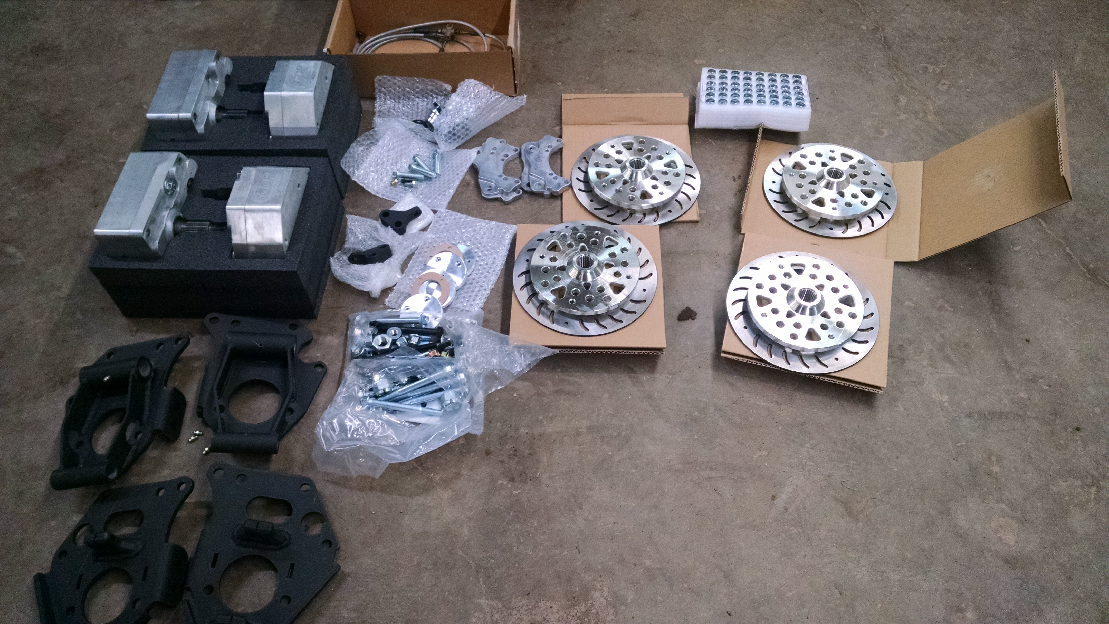

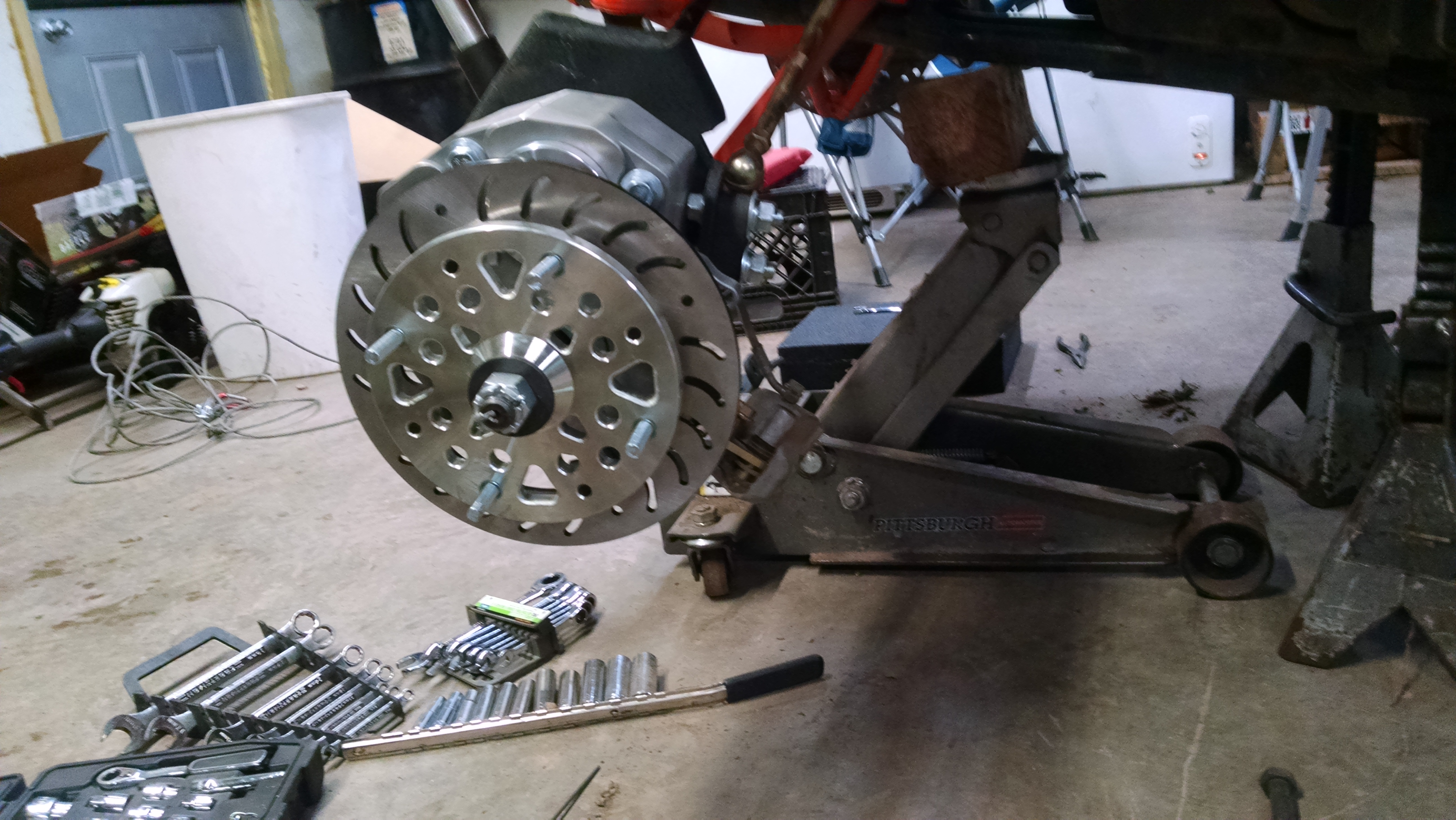

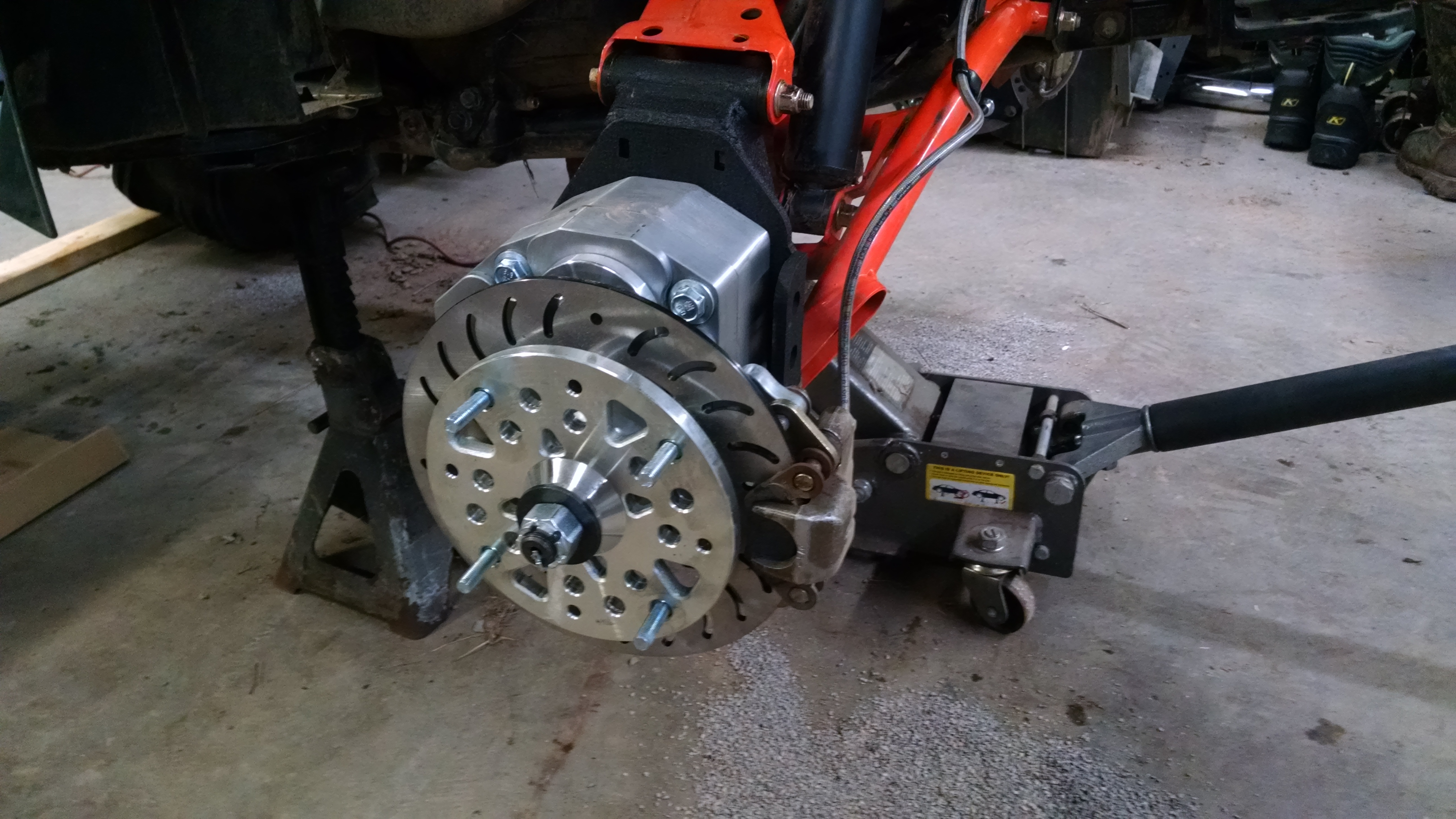

Here's before, during, and after pics as promised. You basically have to assemble everything, but not that bad to do. The backing plates connect to the balljoints and tie rod, gear box bolts to that, big nut gets loctited to the axle up top and then a sealed cover goes over it, caliper bracket to the gearbox, hub/rotor assembly (they provide 3 different sets of lugs that need to be pressed in-just need to choose the set for your machine) goes on bottom splined shaft and is secured with a castle nut like oem hubs. Brake lines are also included and those need to be run. Fill the gear boxes with 80w90 and you're ready to roll.

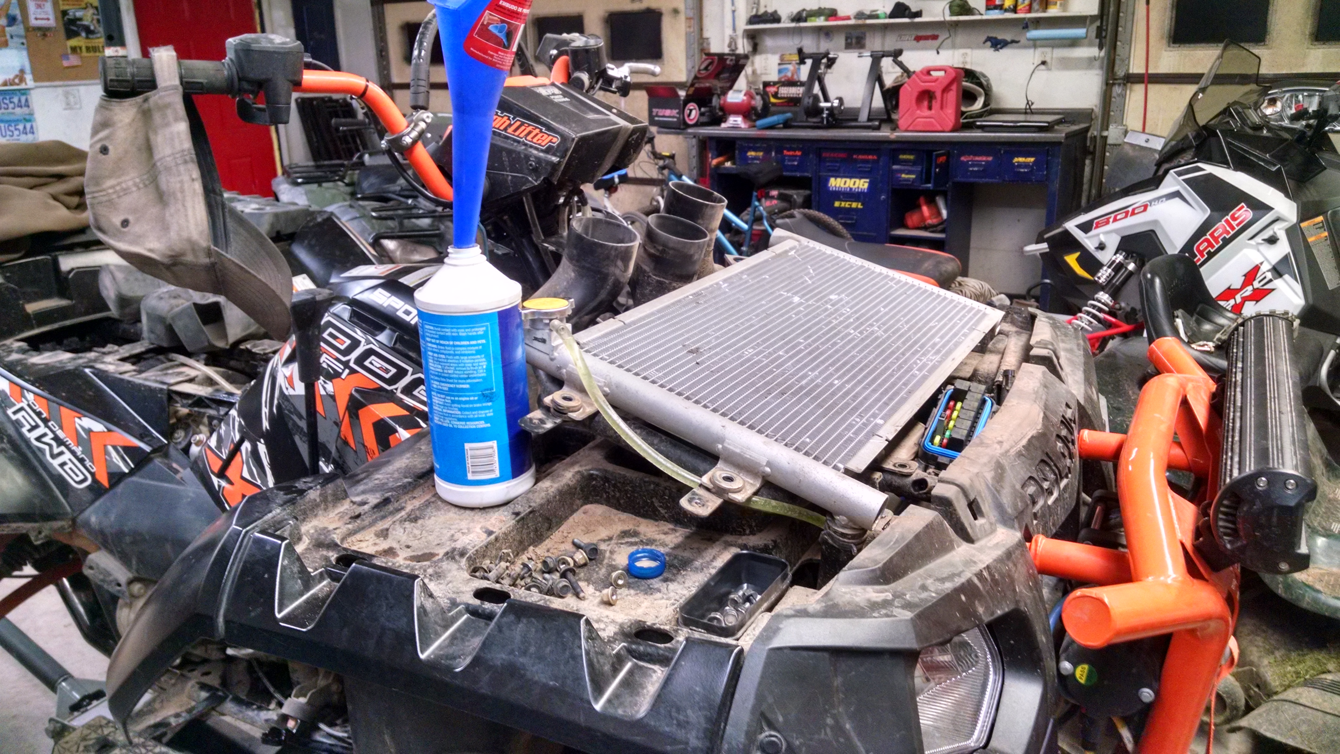

Few minor issues. First, the instructions say to use the stock bolts from the ball-joints but they're too small diameter so I had to remedy that. Second, the hardware kit was missing a few things which I was able to get locally and the retailer credited me for them (kudos to them). Third, the rear brake lines were a major pain because the stock lines were pressed on to the splitter in the rear so I had to remove the whole assembly (lines and splitter provided in the kit) which meant taking the right footwell off (not a bad job). The biggest pain on the rear brakes was the master cylinder location. The brilliant minds at Polaris never moved it on the Highlifter model so it was left under the plastic below the speedo pod which meant I had to remove a TON of crap up front to get to it (as seen in pic).

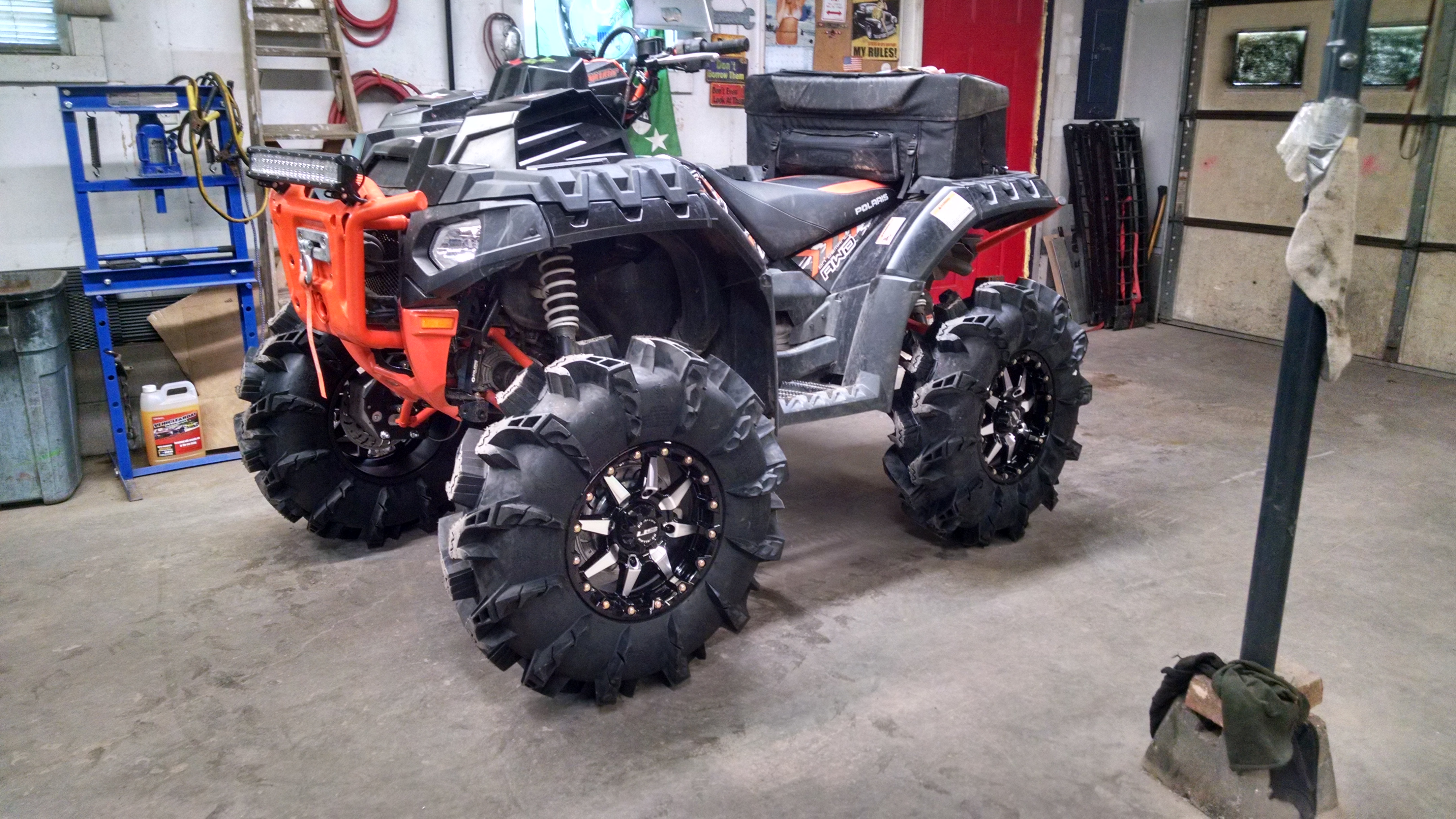

Forgot to include a bucket pic with the new tires on (stock 29.5's shown) but the new tires give me 8 inches of clearance from the top of a 5 gallon bucket to bottom of frame- INCREDIBLE!!!
Got to finally take it for a test run yesterday and everything works great- rode a new area with some buddies and they said some of the holes I got through without help hadn't been made unassisted by anyone since the floods we had @ 4 years ago.
Keep in mind if you ever plan on going this route the lift gives you a 30% gear reduction so top speed will take a hit. On my machine it came with a 25% gear reduction in the tranny so my top speed now is maybe 45 mph- she's turning @ 5900 rpm at 40 in high range. Not a big deal for me since I'd rather putz around from hole to hole.
