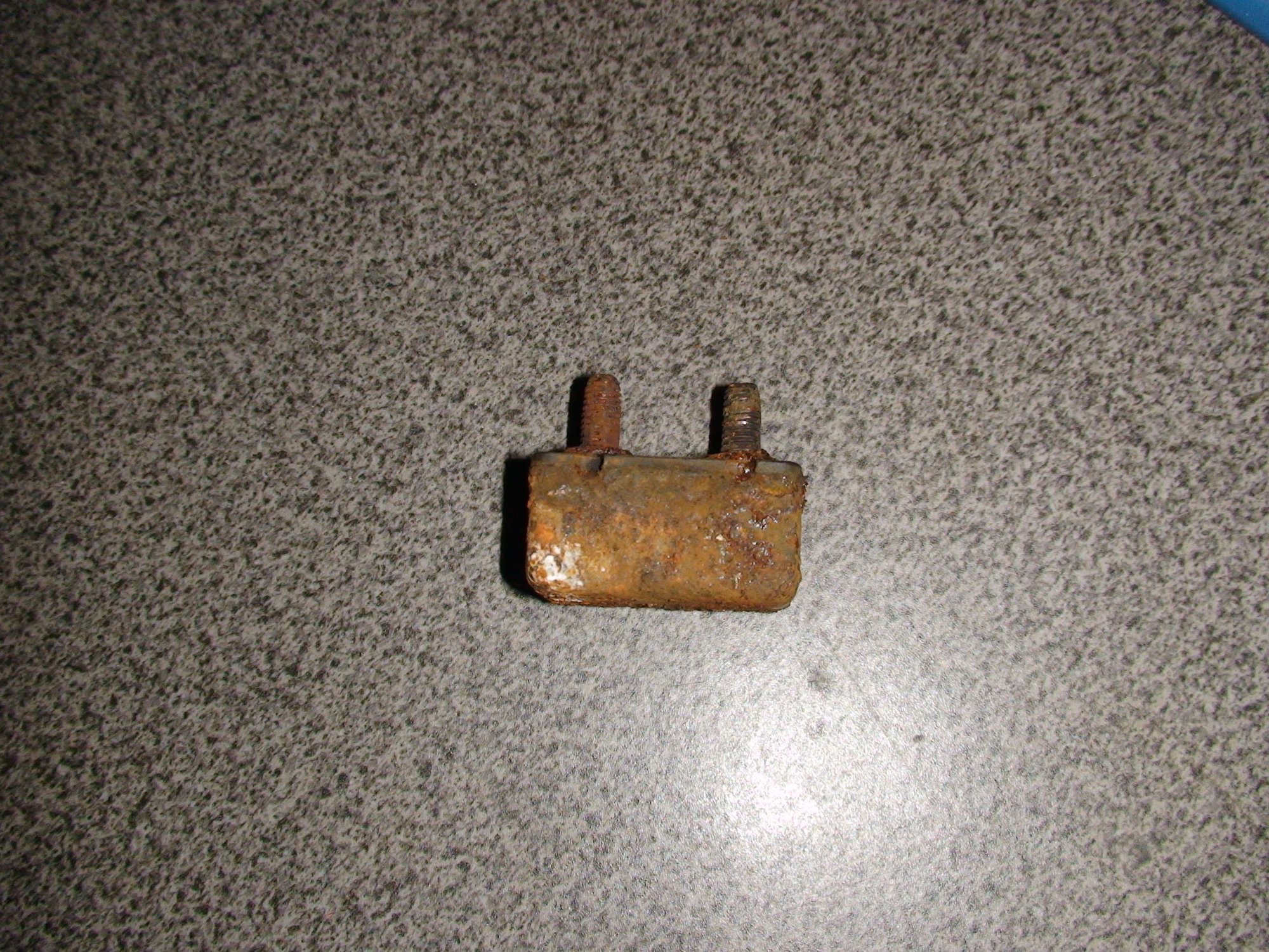

Just split the bag open and change out the 20 amp circuit breaker. They get weak from use over time,can trip and then reset plus corrode from moisture and do the same thing. Here's a good breaker compared to a couple worn,corroded ones.You can get these at any auto supply for a few bucks.

Thanks Old Polaris Tech. I was hoping you would chime in on this one. I didn't cut open the bag yet, but I will try this. seems a lot easier than what I had in mind. It just wasn't feeling like that is the issue, but it won't hurt to give this a go.

Old Polaris Tech, thank you for your suggestion. The auto parts store only had a 15amp and a 30 amp on hand, I went with the 15 because I wanted to get rolling right away.
I didn't think it would be so rotted since it was sealed in a bag.
I idled it for about 10 mins running the lights and hand/thumb warmers and it didn't pop, so I think you did it!
