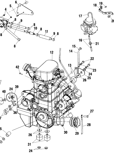

Hoping someone can assist in finding the 2nd chassis ground location on my 03 Polaris Sportsman 700. I have located the ground on the right hand side of the ATV, on the chassis. But I cannot locate the other chassis ground.
I'm running thru all the electrical connections and cleaning them up, and would really like to find this 2nd chassis ground. Thanks!
Old Jan 15, 2017 | 02:27 PM
Item#14 is the top engine bracket ground. Battery negative cable to engine case if I remember correctly. Smaller grounds on coil mounting tab or against the frame.
Attached Thumbnails 2003 Polaris Sportsman 700 - where are chassis grounds located?-index.png
