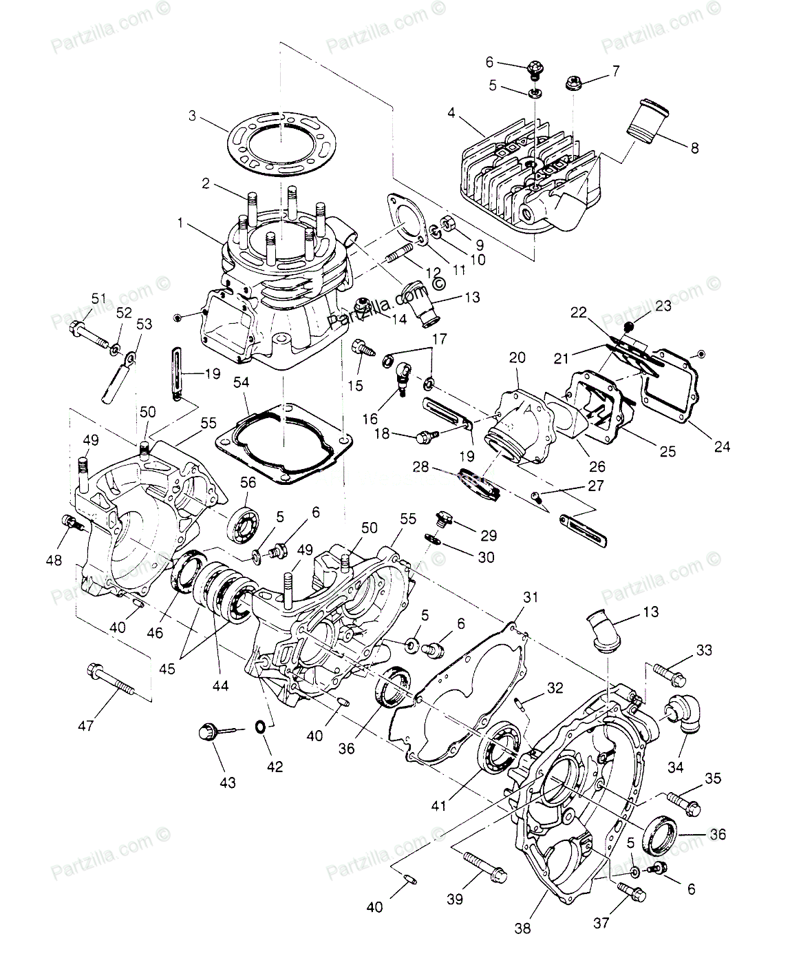

Counter balancer seal replacement is the same as the crank seal. Just pop it out and replace it. Also just oil up the bushing that goes into this seal and twist it in so it doesn't damage or distort the seal lips. Counter balancer cavity seal is the same size as the crank seal. Item #36 (2)

Now do I have to pull the counterbalance itself to remove the gear from the crank or can that be pulled separately so the seal can be replaced? And if u can, do I just need a regular puller to remove the gear? I hope I can run this thing enough and it will clear up but I'm planning for worst case scenario if it still pulls oil into the case.

Counter balance doesn't have to be removed,but make sure the marks on the c/b and crank gear line up after seal replacement. Gear may just pry off or a two jaw puller long enough can pull the gear.It's keyed so you can slowly line the gear up on the crank shaft and turn the c/b sprocket until the dots line up then push the crank sprocket all the way in.
