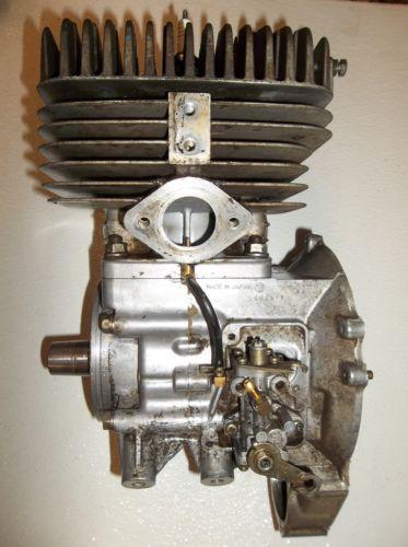

I am in the process of a rebuild of a 96 Polaris trailblazer 250. I just need too know where the oil injection feed line to the engine connects at?

Main oil line from the oil tank to the oil pump. Small line from the pump to the injector nozzle at the base of the cylinder.Make sure you open the oil pump bleed screw at the top of the pump until all air bubbles are removed. Premix the first tank of fuel 50:1 to help assist the oil pump during break in.

. Thanks bud, kept seeing different stories didn't know which was accurate and manual does not show that setup clearly. Thanks again
