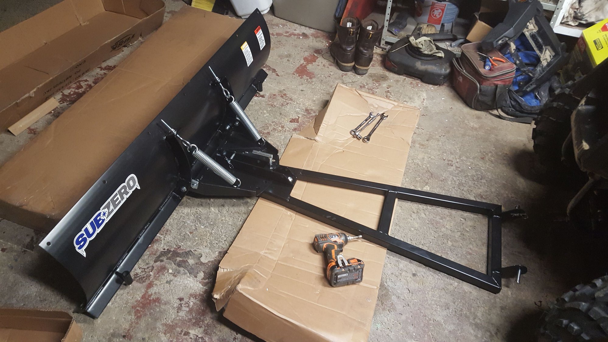

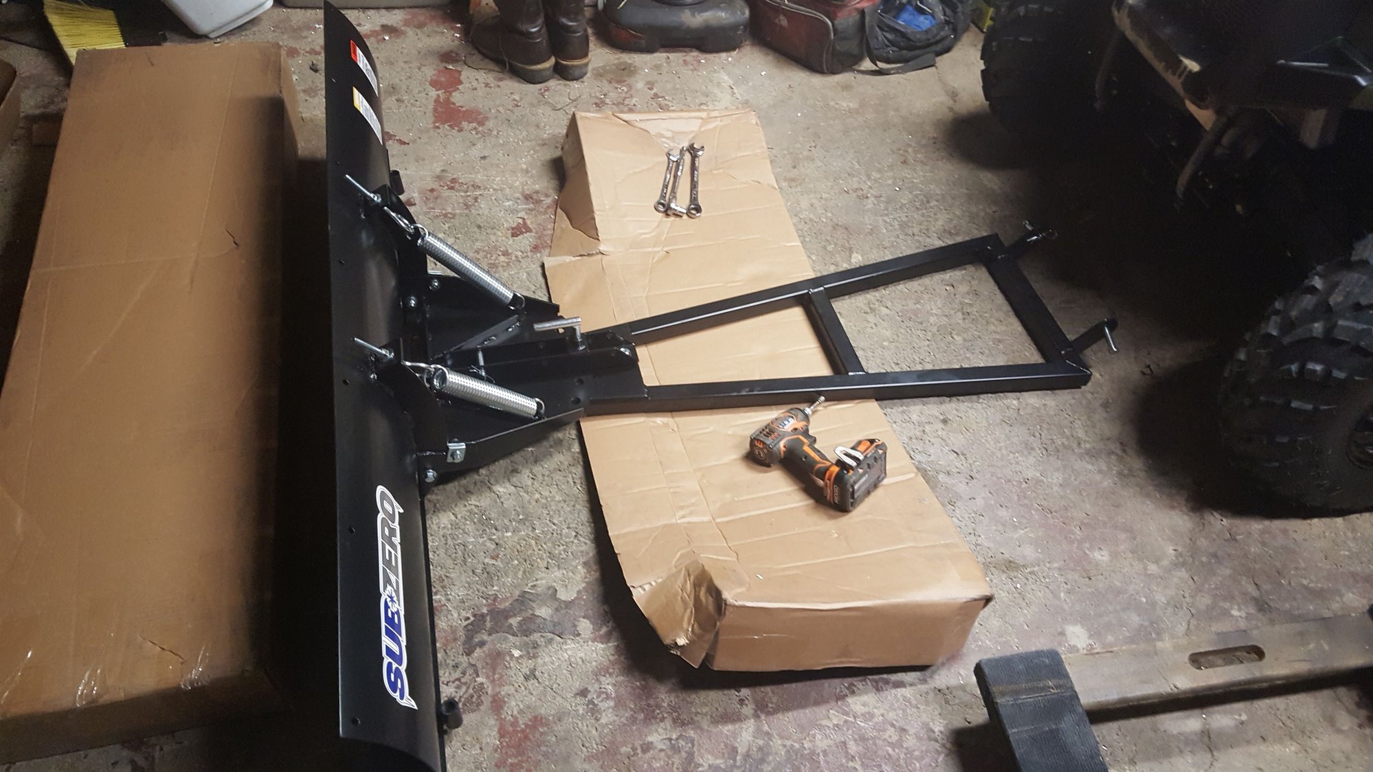

Still waiting on my mount that is coming tomorrow and also waiting for the correct winch mount that will be here Friday but I got the plow and push tubes today and put it together. It us definitely a nice plow, the push tubes are 1-1/2 inch square tube and is alot sturdier than my previous plows with push tubes. Went with the 60 inch and the whole package with atv mount shipped to my door for $309. It's not the fancy Polaris quick mount but for less than half the price I'm sure it will do just fine. Now I can use that money towards other goodies. Plow, winch and mount cost me $447

It sounds like you got a good deal. Do you have the skids to keep the plow from wearing out as fast? I can't see if it has a wear bar but I assume it does. Most can be flipped over so you get twice as much use out of it. On a new blade I like to adjust the skids so they're almost touching the ground. After a little use the wear bar grinds down just enough to be in perfect adjustment.

Yes I have the skids. Just not on the plow yet. Final adjustments will be made once I get the winch mount Friday. Then I can install the winch and hook the plow up to make adjustments
