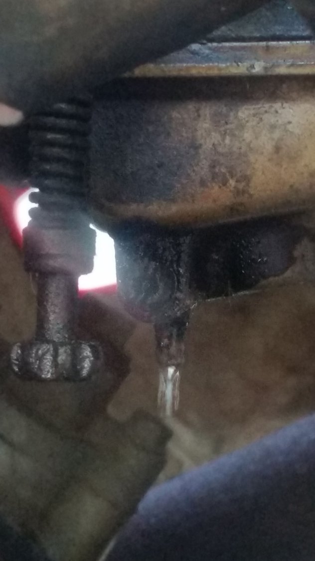

Ok so the valve underneath the carburetor is leaking fuel. Adjustment screw won't stop it. Tank is now empty.
Old Oct 14, 2017 | 10:26 AM
Other than sounding like it may need a new plug,sounds like a float sticking or a needle and seat worn causing gas to flow into the air box.If you take a carb off rebuild it don't just try to clean one. Same BST34 carb as used on the 2000 Sportsman 500.Polaris Sportsman 500 Carburetor Repair Kit Fits 1999-2000 Carb: Shindy 03-416 | eBay I'd make sure the oil level is ok and doesn't smell like gas also. A lot of oil to change if it does.

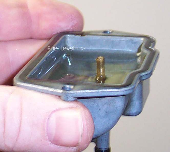

The screw blocks an opening in the bowl that you can use to drain the bowl if needed. The top of the tube is open and if fuel level gets above it,fuel will flow straight out onto the ground.This is the overflow of the brass tube. Remove the carb and bowl,fill bowl with fuel below the top of the tube and see if it leaks. If it does either the bowl screw could be damaged,not able to shut off fuel, or the brass tube may be leaking where it's soldered in the bowl. IF it's not leaking the problem is a worn needle and seat,float level off or sticking, allowing fuel level to go too high and out the over flow tube. Once you take a carb off I'd rebuild it. Nothing worse than to just clean a carb and still have problems.
