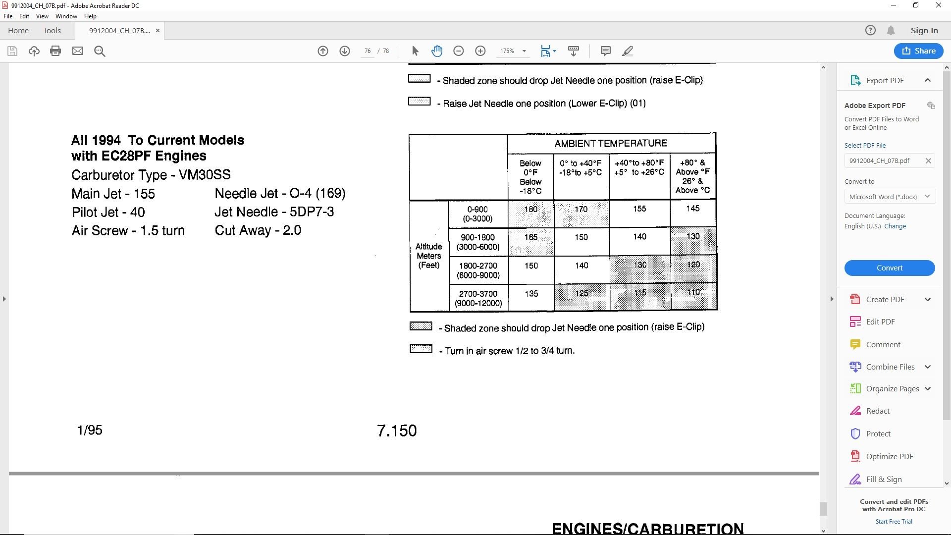

Air/fuel probably about 1.5 out. Not looking at a manual currently.
idle screw needs set after you warm it up. Not really a start setting like the air fuel.
Clip on needle I would bet in 3rd position. Will try to remember to verify tomorrow.

Well I guess you get the picture twice! Just in case you weren't sure on the needle clip position "5DP7-3" tells you. 5DP7 is the number on the needle and the "3" is the location it belongs in.
