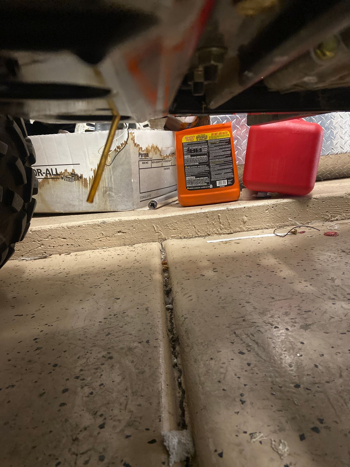

I have an 2005 Polaris trail boss 330. When I try to turn the gas valve on gas leaks from a tube coming our the bottom. I don’t know where that’s suppose to connect to or if it’s suppose to have a plug. If anyone can tell me what that is thanks you.

Could be the screw for the drain bowl is open if the hose is at the bottom of the carb.
