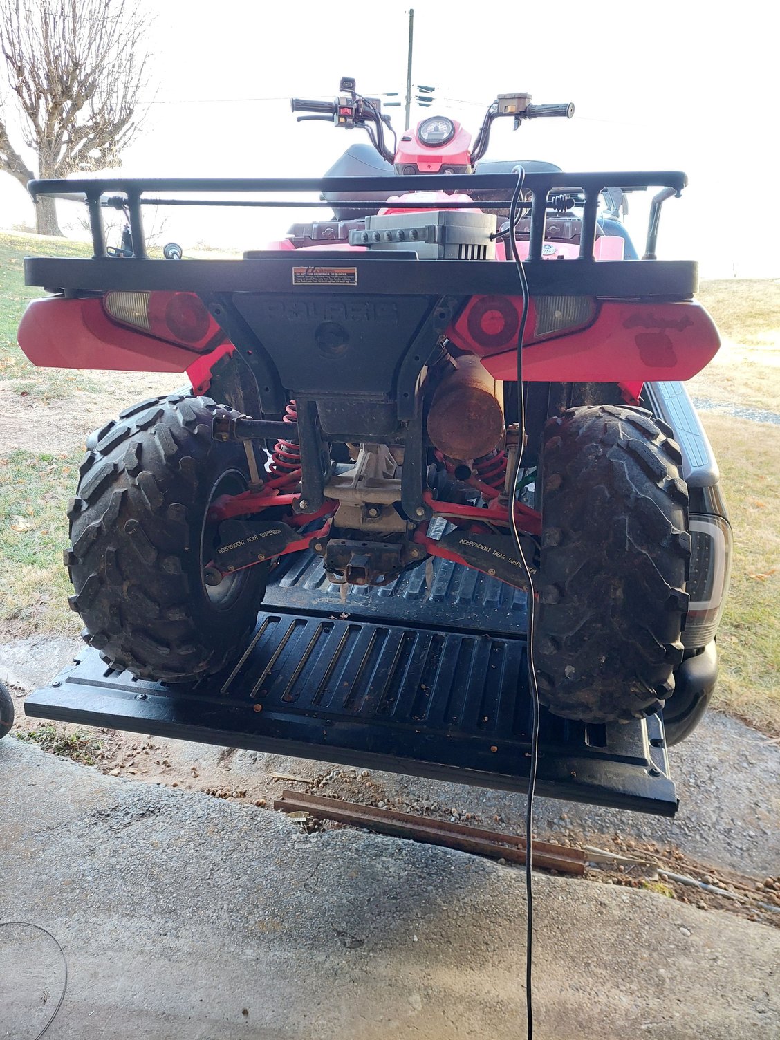

Here is the 'new to me' shot of the Polaris in my Tacoma headed from Virginia to good ole East Tennessee.

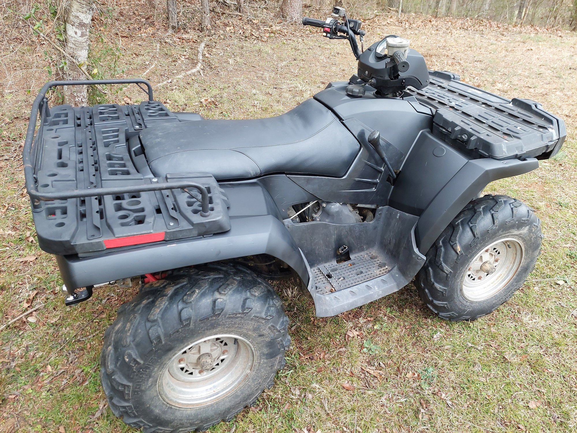

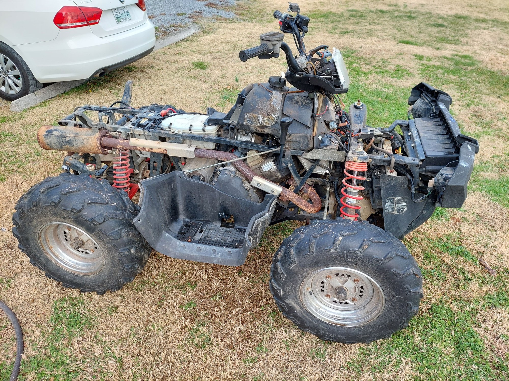

The plastics were that ugly red/pink so I pulled them off and tossed an flat-black paint on them and also looked at what is underneath.

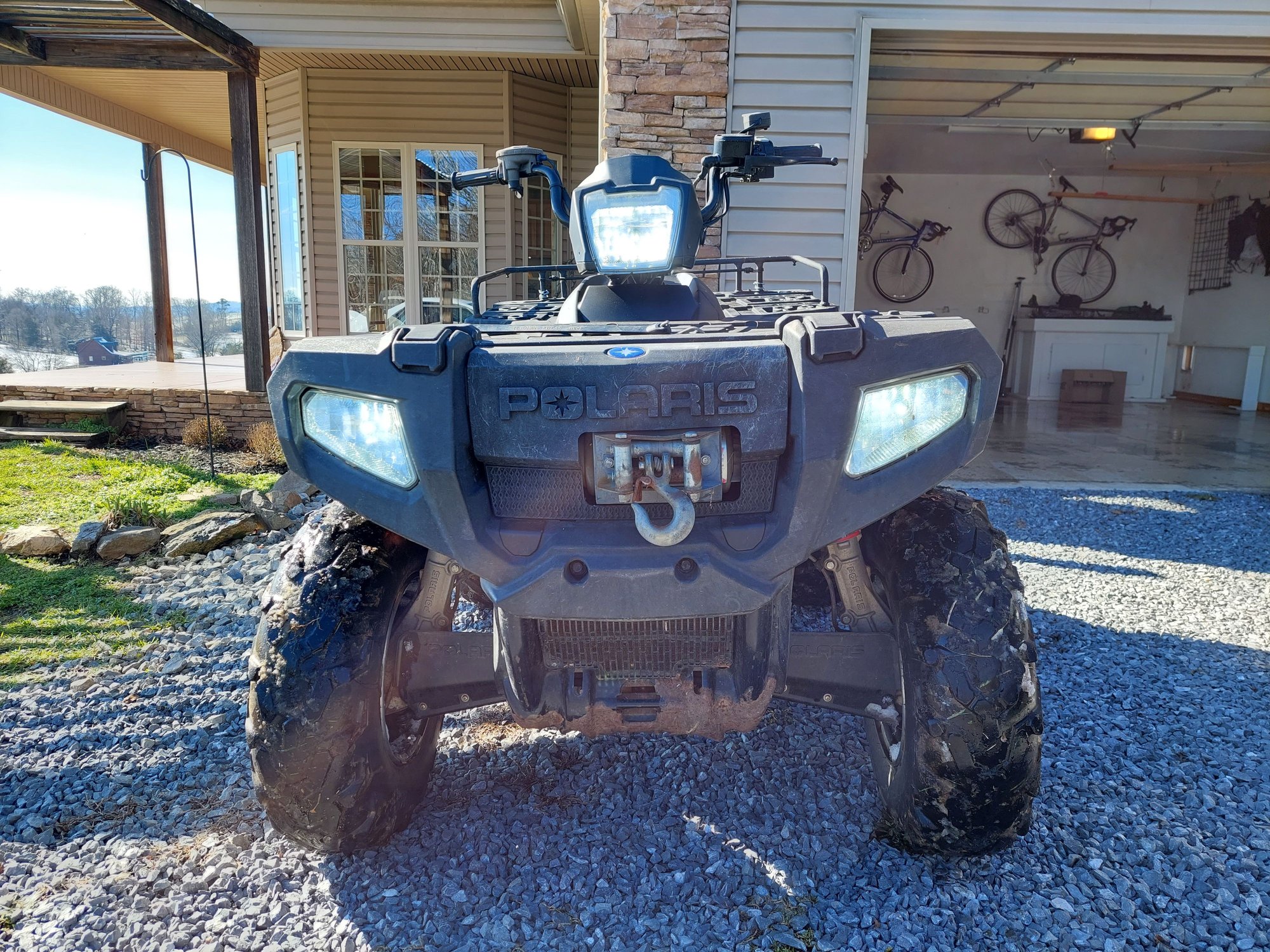

It has some vibrational issues I've been trying to locate and work out. Changed out all the bulbs to LED bulbs which adds a lot more light and I also wired the HI to include the LOW for greater visibility!

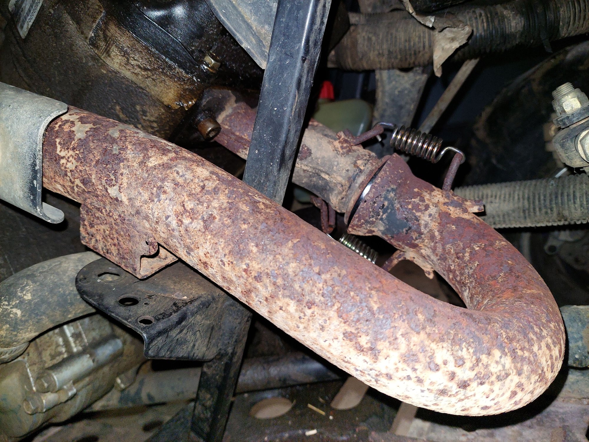

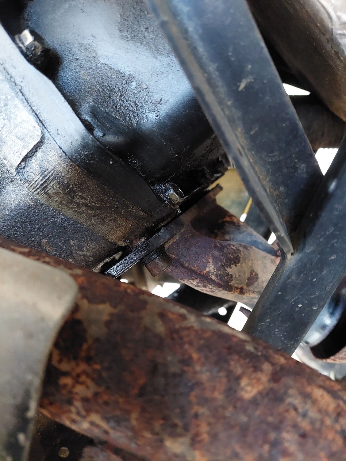

1. There is some oil? leaking here where the exhaust manifold is. Any advice on what that might be? You can see I'm replacing the donut while I am working on the pipe. Not sure if the oil is coming from the gasket and dripping down to the manifold or just what. Many internet searches threw a variety of options at me.
2. The mount for the pipe after making the 180 degree bend from the exhaust manifold is not attached to the support plate. I tried looking at diagrams and such but can't quite find the bolt/rubber attachment for that section. Anyone have any advice?

Here is a better shot of the pipe bracket and the installation of the new donut and tension springs.

the mount for the mid pipe, I believe, is a rubber isolator/stud. I would show you what my ‘06 700 carbureted sportsman has, but it’s in my cousins garage currently.
As for the muffler, I personally recommend just replacing the factory silencer with an aftermarket. Multiple options out there, and most claim some kind of gain in low end, and even a bit of top end over stock. Depending on what you wind up putting on there you may need to get a tuner for it to adjust the fuel delivery.
some of the rattles I would think would be from not having the mid pipe secured correctly, but most of what rattles on mine are the side covers just below the seat.
As for the oil leak, there’s the rocker cover gasket, and I’m pretty sure the fuel injected models still had the reed valve for the crank breather. The cover for the breather reed valve tends to warp over time, and not seal. They make billet aluminum ones, and the reed valve itself has the rubber seal.
what did you use for paint on the plastics? I actually kindof like that blacked out look you have going on. 👍

As far as the paint, I just grabbed some primer/paint spray-paint combo that works on plastics. It's alright, if I scrap it off I just shot a small amount on it again if the red starts to show through. I'll grab a photo of the paint later.

Dropped the beast off at a friends house who does small engine repair. He found my noise source... a crack in the frame! 5 minutes on the MIG welder and all fixed! Glad it wasn't an internal issue. He's replacing the rear bushings (more than half were missing!) and doing the typical maintenance. A new valve-cover gasket fixed the leak in the previous pictures. New tires were ordered and dropped off with him as well, so when I pick it up in the next several days, I'll provide some updates and pictures!
